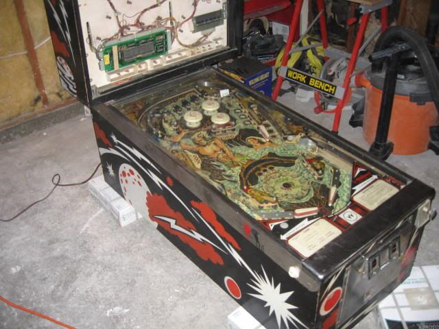

OK, figured I'd start a thread for my Williams Flash Pinball rebuild. It is my first pin, and I have gotten myself in pretty deep. I explained a couple of things in my prevous first pin post, but i figured this thread will follow progress and allow people to yell at me when I do things wrong.
Here are a cpouple of pic:

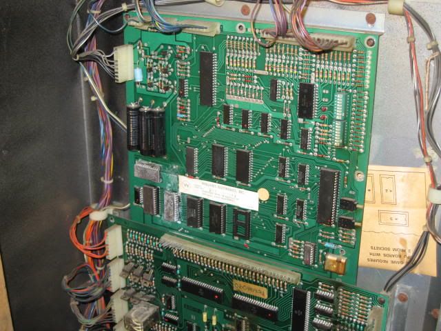

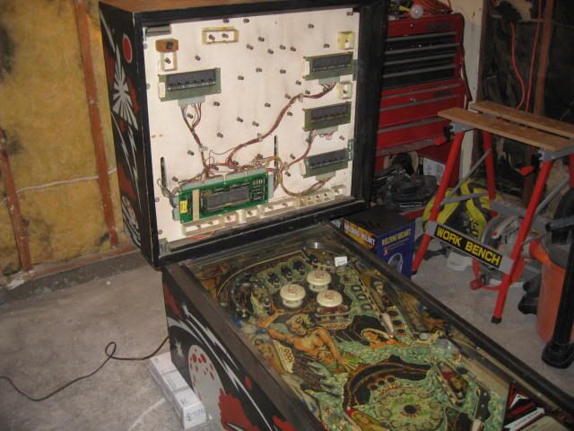

First, I picked up this pin Wednesday. When it plugs in lights light up, and thats it. The two LED's are lit on the MPU board. After jiggling the MPU board, I hear a "bong" from the speaker, a selanoid clicks, and the LED's go off, but the gme is still inoperable.
Before I do a complete tear down, clean, wax and make everything look nice, I would like to get the machien into some working order,this way I know it works BEFORE I pull it apart, that way if it doesn't after, I know it was something I did.

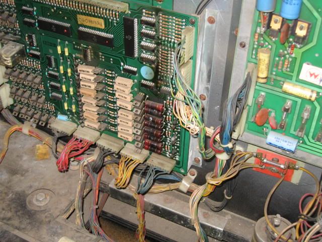

Some things I noticed so far:

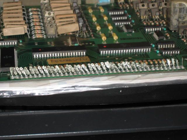

In this pic, you can see a couple of things. First, the AA batteries are hard soldered in, so I will have to get a battery holder and replace that. Below that, you can see two of the IC's are dis-colored, and very loose, guessing from acid leakage from the batteries. Also in this pic you can see the 40 pin connector between the two boards has had some work done. It appears that some of the male pins were replaced at some point as they a sticking out a great deal (left side of the plug).
In this pic you can see there is some black area near the reddish resistors(?). Other than that, I don't really know. I have no experience with a logic probe, but I will order one this week and start testing the IC's. Any other ideas or comments welcome. Also, just wanted to say thanks to Mike from economy pinball repair in Long Island and New York City http://economypinballrepair.weebly.com/
He took some time to go through a bunch of crap over the phone, very thurough. He definitley knows his stuff.

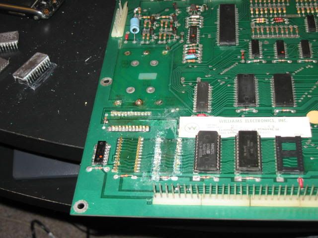

Did a little more investigating. I took the Main board and the driver board out of the backbox. After pulling them apart I noticed that it wasn't that the male plugs of the interconnector were longer as I thought, the previous owner, or who ever, used the molex connectors along with some solid wire, to wedge into parts of the 40 pin connector that had been messed up. Here is a closer shot of that:

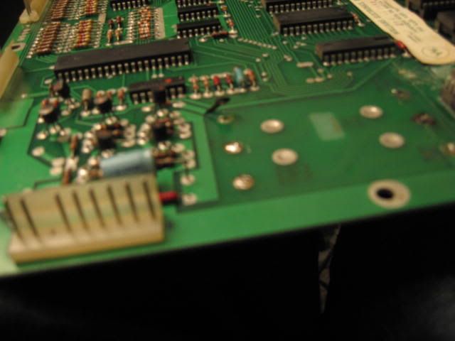

Also, upon de-soldering the hard wired batteries, I noticed the trace was completely coming off the board...all thanks to the leakage. You can kind of see it in this shot:
I am going to get a cheap battery box and mount it completely off of the board as suggested. First I have to take out the corroded components (looks like 2 IC's and a diode), and give the board a vinegar/water bath.

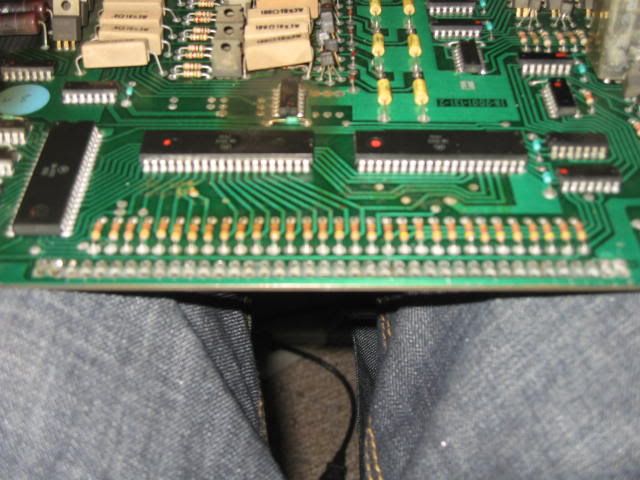

You've already spotted the big things to take care of. That 40pin on the driver board is hosed, and you need to replace the ROM sockets that are corroded. But from the sounds of it, you're at least marginally booting up, which is a good sign. A non-booting board is tough to diagnose, but anything else is normally easy to take care of. I'd also recommend resoldering the 40pin on the CPU board, and doing new male header pins on the CPU and power supply boards for the logic power circuit. All of these tend to get cracked solder joints.
The driver board, those resistors always bake like that. The transistors driving the lamp matrix take a lot of power to operate, and the resistors get up to 200 degrees or so. The heat also causes havok with the switch matrix, and I see the PIA and logic chips fail in that circuit, usually with delaminated traces and pads. Here's one way to take care of that heat problem permanently..... toward the end of this page.(as I pimp my website a bit)

The sockets you have there are the RN brand. They aren't bad as they contact on the flats of the legs, but they are single-wipe and 30+ years old. I'm just a paranoid perfectionist, in reality your existing sockets that aren't corroded should be fine. The other ones, the Scanbe's, those are just horrible..... thankfully you don't have them.
As to the ROM chips, yeah, the old ones are basically junk at this point. The good news is that you won't be using the same corroded sockets. Pull the three corroded chips, and put one new chip in that socket which is currently empty. Everything I'm seeing so far says that you don't need to do any changes to the board like you would on Firepower.
The three game ROM's are definitely toast, those are the corroded ones, and they hold the ruleset that's specific to FLASH. The other two ROM's there are called the "Flipper" ROM's, and those hold the operating system that's the same on all the System 4 boards... these don't look like the corrosion hit them at all. I figured in this case a picture would help avoid confusion.

My next step, tonight, I'm going to give the board a vinegar bath to get rid of the battery alkaline. Any tips in this? Half vinegar half water? Then tooth brush, then dry?

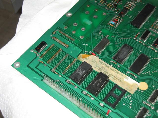

OK, started prepping the boards. Here I pulled the chips and the sockets off of the board:
After that I cut the 40 pin plastic off of the board:
Then I desoldered all the pins from the board:
Finally I gave the MPU board a 1/2 vinegar and 1/2 water bath and scrubbed it with a tooth brush. This is what it looked like after:
I have the 40 pin replacement kit on order, should be arriving some time next week. I also plan on hopefully getting the IC14 EPROM chip from Hans this weekend. At that point I hope the machine will show somes signs of life. Then I can move on to other upgrades and restoration points. I will update when the parts are received and I install them.
Well, I replaced the 40 PIN and installed the new chip...and no change. No lights on the board now...every time I start it. So I know the 40 pin replacement did something. I didn't hear the selenoids click or anything, so I am unsure what that means. Tips? Thoughts?
When you pulled the old socket bodies off, did you leave the pins sticking out? Should cut them off at the very least, if any of them are touching it will screw with the addressing and data.
