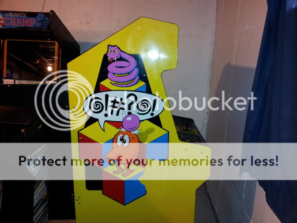

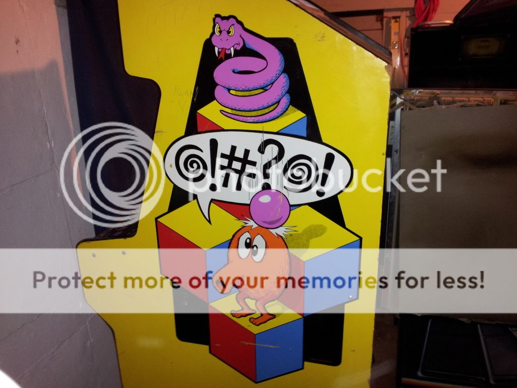

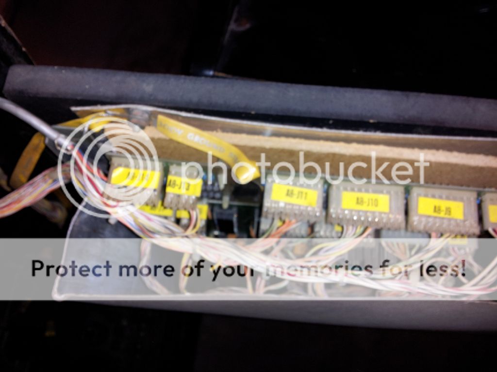

Pick this up this Friday. Pretty decent shape. One side of the side art is missing a chunk and it could use a new CPO. Joystick is a bit loose. Monitor a some burn in it but still looks good. Knocker works! Sound was working until I got it downstairs into my basement. I'll have to troubleshoot that one later.
I would check the fuses.
The sound board is notorious for failure. Might need a rebuild. Does speech work?
Check all voltages to make sure they are good.

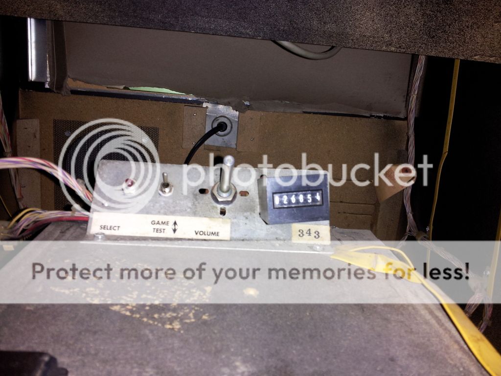

I get no sounds at all. If I mess with the volume knob, I get a loud hum, but that is it
Check the voltages going to the sound board. Check all connections.
My guess is that it's either that or the board needs repair. If you need a speech chip they are semi-hard to find but do come up for sale. My sound board needed repair and a speech chip which I got from Quarterarcade.

I'll check on the numbers tonite. I took the carboard off last night so I could get at the boards to do some troubleshooting. I still have it so I may put it back once I get everything straightened out
