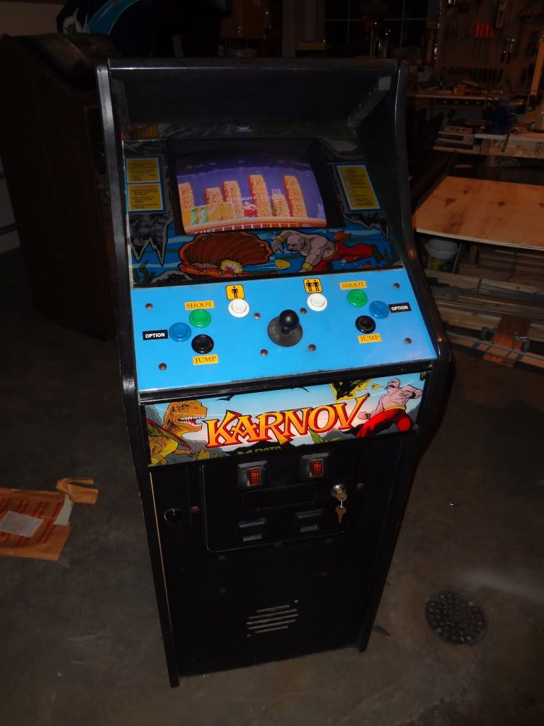

My Trimline Conversion Project
I love how this looks. One thing that I noticed, and very minor detail...but whenever I cut a cardboard bezel for a game, I hate the bright white edge that is left on the seam. Have you ever thought about running a black sharpie along that edge to hide the white? Not a huge biggie though.
That bezel is adhesive backed vinyl and already stuck to tinted plexi. A piece of clear plexi will go over that.

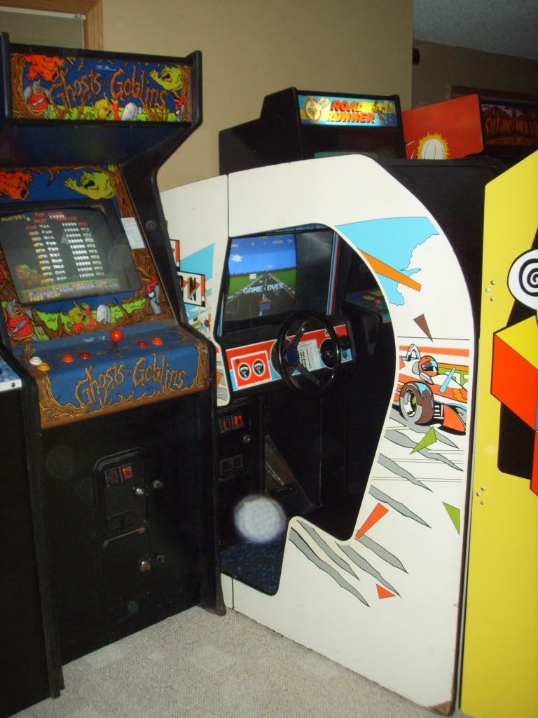

Pics of an upright for visual and color comparison (note the one I owned in the last 3 pics had a black kickplate):

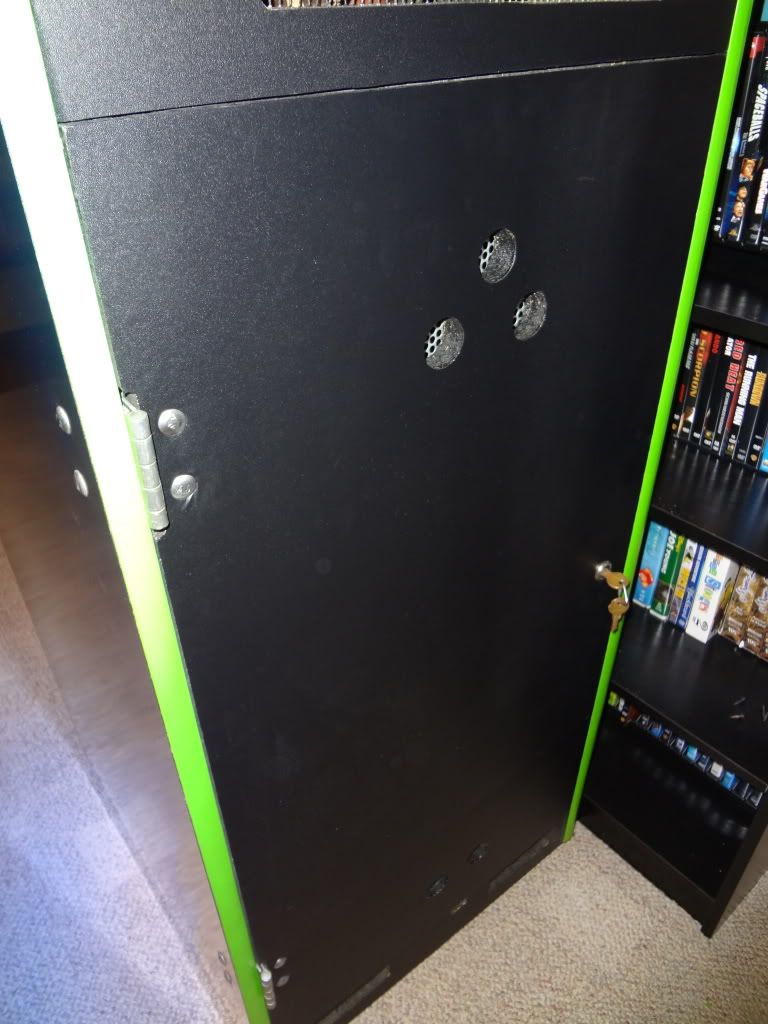

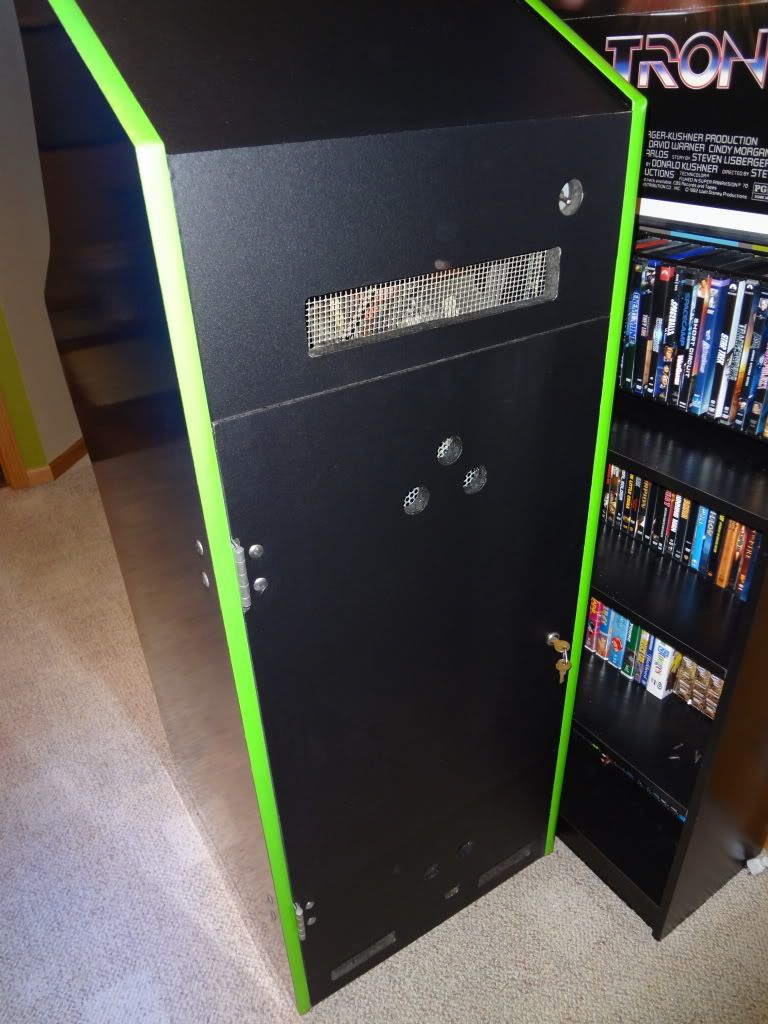

Newly vinyled backdoor with freshly pained vent screens well hung:

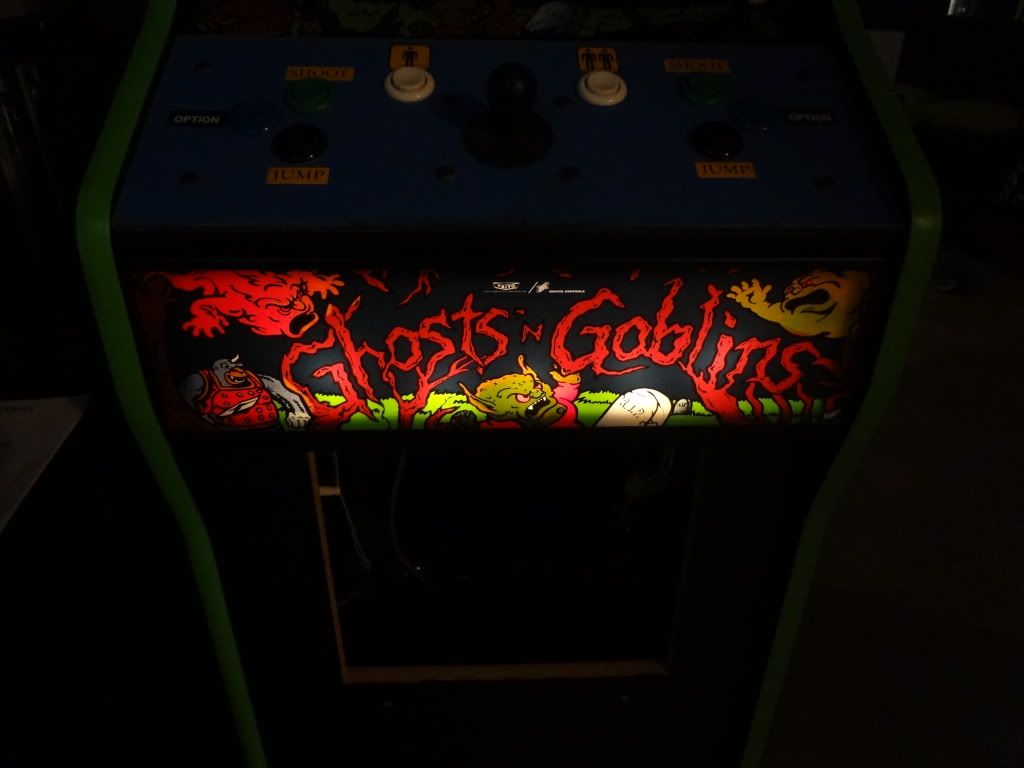

Installed the light fixture and all wiring. Marquee lit up:
GNG all geared up and ready to play:

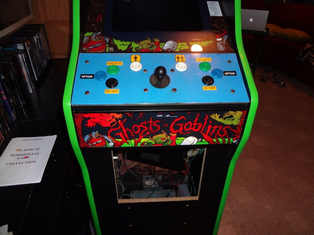

And the pathetic converted CP/CPO I'm still stuck with as I can't find a scan or vector file for the GNG CPO:
For now, I am gonna build a new CP and wrap it in the same purple vinyl I used on the sides. Should someone ever help me out with the CPO, I'll put that over the purple vinyl. Other minor details:

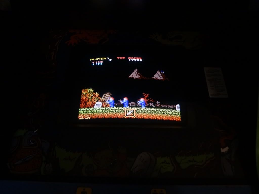

And this is a good example of what a difference a ground plug can make. You can see the diagonal hum bars in the Karnov screen before I replaced the 2 prong plug with a 3 prong:
Before:
After:
It's the little things man.

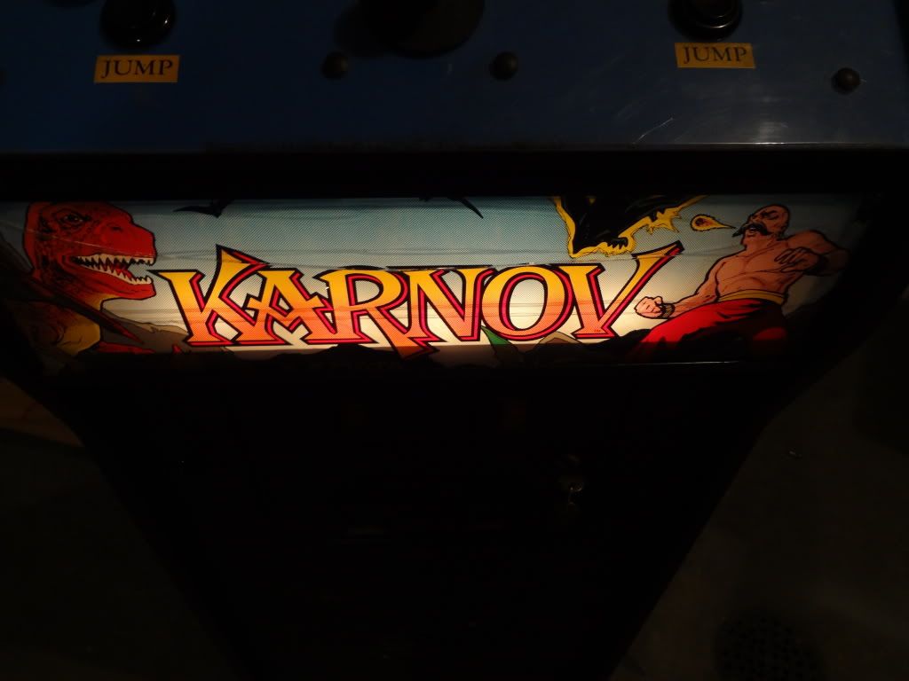

And a comparison shot of the 'original' hacked n cracked (but screened) Karnov marquee vs. the new ink jet GNG marquee from GOG:
