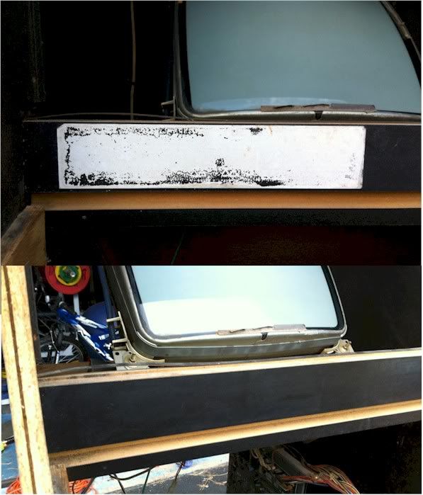

Can someone tell me what that black cardboard shroud is called that goes around the monitor? Bezel, shroud, ???
Thanks!
picture.php
Monitor Shroud. Probably easiest to create one using black poster board.
Now that's a cool resto thread! He has the benefit of a mostly intact shroud. I do not. So my biggest issue is getting the monitor hole done right. But I guess as cheap as poster board is, I can buy a few sheets and give it a go. Thanks!

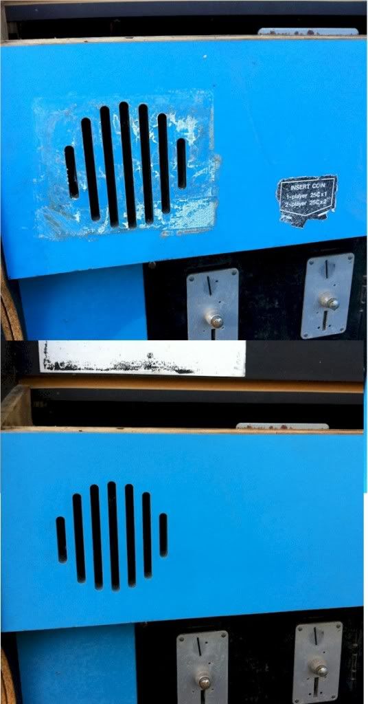

Just baby steps, but I did get the Power Supply swapped out which is nothing, but took lots of time and cleaned up the individual wires that all were mostly coated with a muddy looking film. And cleaned off some glue and old stickers that were pretty much worthless:
This is Mason, my youngest son. Soaking up some nice weather and helping out his dear ole' Dad. ;)
I just ordered a new instruction sticker and Gutsman says he has the Insert Coin sticker for me.
