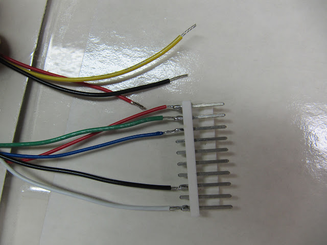

My particular build is a daughter board, with a connector on the bottom to plug right on top of the 10 pin header on the board. This is a VERY elegant way of getting the conversion components on the chassis. This build takes a bit of skill to do. Here's a good shot of my build, including the wiring for RGB and Power. I end the wires to a standard JAMMA cab monitor connector. The 3 wires for power are also left ready to be hooked up. I am running alligator clips out of my test rig to test monitors easily.
Wires exiting the monitor:
Got mine, thanks. I have a few questions. I know the yellow wire is 12V and the black is Ground. Is the red wire coming off of the smaller board 5V? Also, can a frame be made for these? I assume this tagboard housing was for shipping? Man this is a cool ass little monitor and I cannot wait to hook it up to some of my tiny jamma boards.
