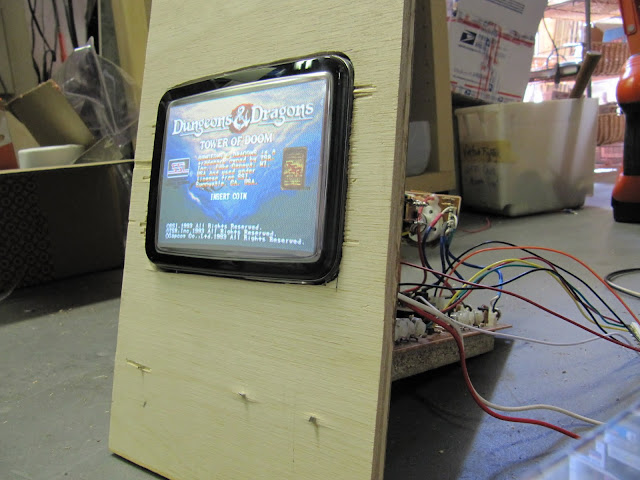

I decided to go ahead and start taking orders for kits to be put together next week. I'll a handful for parts kits and/or drop in boards till my new order of LM1881N chips come in.
I've ordered 20 more but have about 5 for kits I can start shipping as soon as next week.
built to order drop in boards will come from these first 5 kits.
1) parts kit. I think i'm in the neighborhood of $15
You will get a link to an online PDF for instructions.
You'll need your own wires. I don't want to bother with guessing how you'll mount everything and where for lengths etc.

These are the parts from the top row going across.
* a 2 pin header for use for power
* a 10 pin header.156 pins for video in. (similar to a WG K7000 chassis)
* a LM1881N video sync seperator (8 pin)
* a 74LS04 inverter (14 pin)
* a 14 pin dual wipe socket
* a 8 pin dual wipe socket
* a 10 pin header for connecting the sync wires to the monitor chassis
* two .1 uF ceramic capacitors
* a 620 Ohm 1/4 watt resistor (pink)
* a 680K Ohm 1/4 watt resistor
* a small project PCB board
* a 20K contrast pot

I'm still working on basic instructions cause there is a good guide already @
http://arcade.oxidy.com/info.asp?key=CGA2RGB
We just used a different SYNC splitter.
CDJump already did a drawing of the circut using the chip that I provide in this kit.
http://forums.arcade-museum.com/attachment.php?attachmentid=26513&d=1266279290
My particular build is all-on-one board, with a connector on the bottom to plug right on top of the 10 pin header on the board. You don't have to follow my build cause it's hard actually. You can run wires from the 10 pin connector to your circut and mount your board somewhere else. Here's a good shot of my build, including the wiring for RGB and Power. I also try to get wires going through the PCB to hold the 10 pin header on the bottom of it. Soldering it to the small copper pads insn't very structural and it'll rip those things right off the PCB if that's the only thing holding it to the PCB, when you stick this board onto the monitor chassis.

video added of one I tuned up:
I have to admit that these are not the brightest monitors. If you are in a bright room they look a little washed out. They do work great as bench test monitors and could be used in some very cool projects. I just have not seen anyone do anything arcade related yet othen than use them as a bench test monitor.
