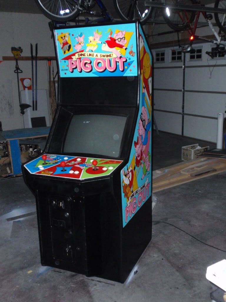

Well since my other thread was getting mired down in auction talk, I figured I'd start a new one complete with pics. Now, this machine is not 100% perfect by any stretch, the side art has some nicks and scrapes, the bottom has a bit of moisture damage and the coin door is currently stripped bare and was painted right over (yes, even the red reject inserts were painted black). I sanded down most of the moisture damage, masked the side art and rolled 2 coats of Rustoleum semi-gloss black on the sides, front panels and the entire back and roof of the game. Marquee bracket was stripped, primed and painted satin black, marquee, marquee plexi and bezel were all removed, cleaned, polished and replaced. The bottom was sanded clean and I installed new textured black T-molding. I have a complete Coin Controls coin door that I am gonna spruce up and replace the one the game came with and I may fill the lock bar hole at a future date. But for now, she works and she's looking pretty damned good. Don't you agree?

I have this officially listed as a B+ on my VAPS entry. But thanks. Like I said, it is not perfect, and at this point I am fine with that. It looks broke in. Once I get a new coindoor put together, it will be very nice. I really like the gameplay on this one. I can see it having years of replay value.
