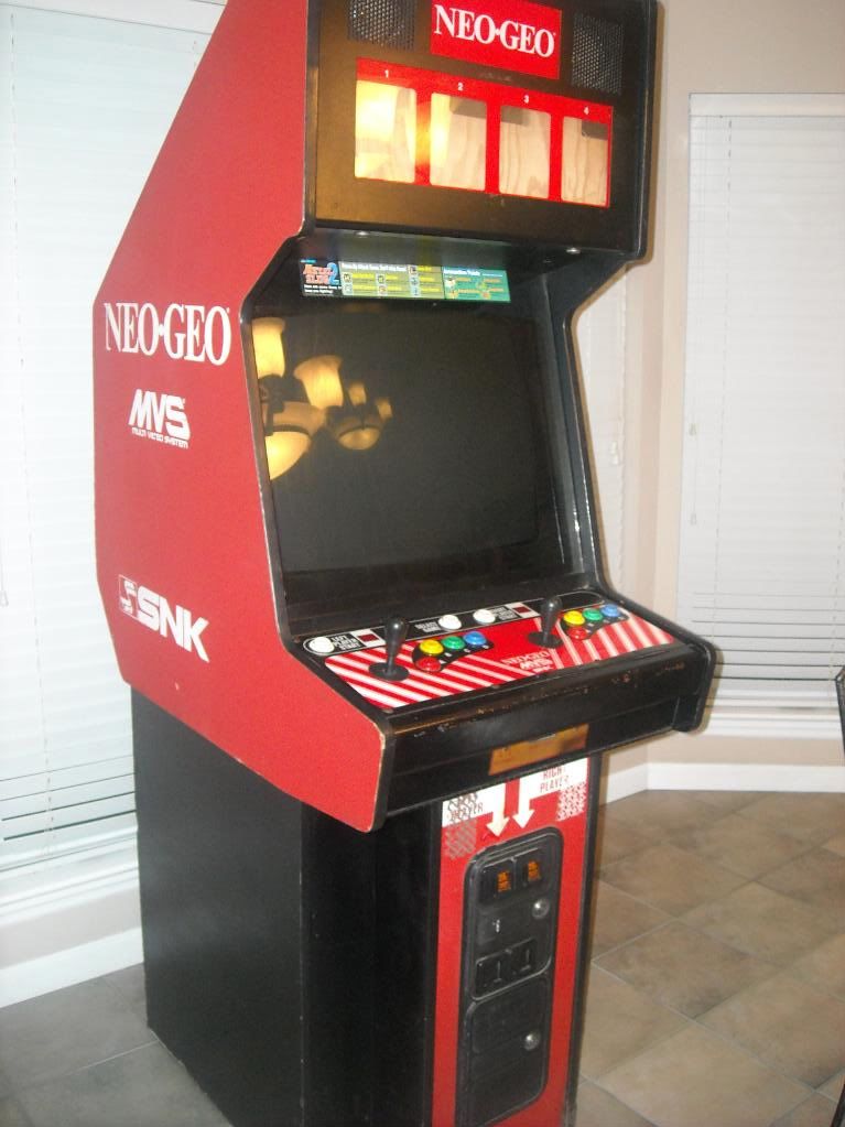

Traded Vectorman my Spiders cabinet for this one...been wanting it for a long time. It's a nice four-slot. Cab is in good condition, and it has part of the Metal Slug 2 stickers still on it. No access to the tubular locks, might have to pick those.
It does have a problem though, which I'll post in the appropriate forum.
Now to fix, then some great NEO action. :)

Very nice! I have the same thing; it was my first (and right now, only) cab that I bought from one of the members here. Guys are always selling MVS carts here for good prices. There might even be a sale thread or two going on right now if you check. I have the 100 in 1 multi (I got it with the cabinet); not too bad. Lot of fighting games, but there's also some other good ones on it too. Puzzle games for the wife and other ones I enjoy, such as Baseball Stars and Neo Turf Masters.

One question. How do I lock down the CP? It has latches, but I don't know how to secure them
There should be slots on the metal CP where the latches "hook" into (should be a lip, and a small slotted hole for where each clip attaches). Note where they are, then close the CP. Reach up through the coindoor for the latches (should be one on the right, one on the left). Hook it, then press the latch lever down. It should "snap" into place.

Update: Got it working! I had to send the board to Canada to be repaired, and I got it back in the mail today. Been playing Samurai Shodown II and Ninja Combat. :)
Thanks again to EagleTG for providing me with a Samurai Shodown II cartridge, and thanks to DavidG on the Neo-Geo Forums for repair.
Might need a degaussing coil though, part of the monitor is a little purple.
The monitor should be new enough that it has one built in.
Generally when you turn it off for about 15 minutes and turn it back on it should degauss itself.
And congratulations on getting it working. Seems like you had a quick turn around on the board repair.
It's not fixing itself. Will this coil work?
http://www.mcmelectronics.com/product/72-785
That one is for CRTs less than 19"
Yours should be a 25", and usually a WG K7000
I would check the connections on the chassis to see if your degauss coil is disconnected or anything. If it is a K7000, it should have one built in. They do get disconnected sometimes.
