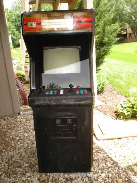

woke up early today to find an add on cl for a street fighter 2 50$
kid said he bought it for 250 3 weeks ago it worked and when he got it home it didnt (said screen wouldent stop scrolling up and down (lol thats a super easy fix just adjust the pots)
well i drive about an hour to go see it and shure as crap it is fully working besides the screen sync problem and it only was playing the background music sounds no player fighter sounds
the cab was fubared so i took a chance and offerd him 20$ and he bit( i would have gave him the 50 if he refused )
here she is not to pretty but oh well nothing a littel wood work and paint wont fix
now on to my ?
first it has an electrohome monitor in it the pots on ther monitor are just metal no nob
how do i adjust them is it ok to touch thoes while the monitor is hot
next is street fighter a stereo game is that why i dont get any fighter sounds or could it be a more serious underlying problem

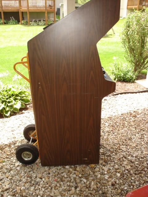

what was the cab originaly looks like it may be an old atari cab (shure is heavy enough to be one )
i can see this side art poking out of the bottom

You need a TV adjustement tool... or use a screwdriver but be careful. (I actually have a set of plastic screw drivers).

looks like a centipede cab to me.

yep. that round graphic part you can see at the bottom is the very bottom part of the mushroom on the side art.
now the tough part do i try and rip off that siding and pray the art is salvageable
and restore the pede (got a good double axle in a dynamo that would be perfect for sf2)or just paint the sucker with my free can of gillden cool cobalt and leave it as a sf2
man really why are these atari cabs soooo heavy they dont seem to have any thicker wood or any extra wood in them compared to other cabs and its just press board what did they doo imbed lead into the darn wood jeese this and my pole position are killing me moving them around

whew got the monitor taken care of
little contact cleaner on the pts and then working them a bunch now no more roll
looks pretty good for a 20$ monitor
its also the first machine i have dealt with with a electrohome monitor dont really know if i like them that much kinda a pia to adjust the pots and whats with not marking the pots function on the damn chassis i guess mabey at one point in time the was probaly a sticker on the frame but god i hate guessing what pot im turning esp when the pots are not quite right to start with

Get yourself a electrohome service manual. While you're at it, also pick up "Grammar can be fun". :eek::D
So... are you gunna pull off the woodgrain and go back to Centipede?

at this time im undicided imgoing to mess around and seewhat the problem is with the sound on the sf2 board then see what it will take to get a pede board set and ps
and the big factor will be when i try to remov the wood grain
