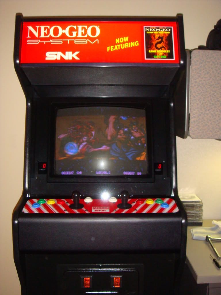

Bought this thing at a local action sight unseen for $60 and took a chance on it. When I got to the place they said it would turn on but not work and it also had no games. Well I took it home and started blowing the dust out of it and came upon 4 carts tucked in the back Shock Troopers, Samurai Showdown 3, Aero Fighters 3, and Prehistoric Isle 2 (this was a huge bonus for me). After cleaning a little I took it inside and plugged it in....turned it on.....and the screen came to a crazy green screen. I let it sit for a while and the thing was up and running. Screen was crisp and clear and everything worked. Anyhow, I tore it apart, fixed it up and made a home for it in my game room.

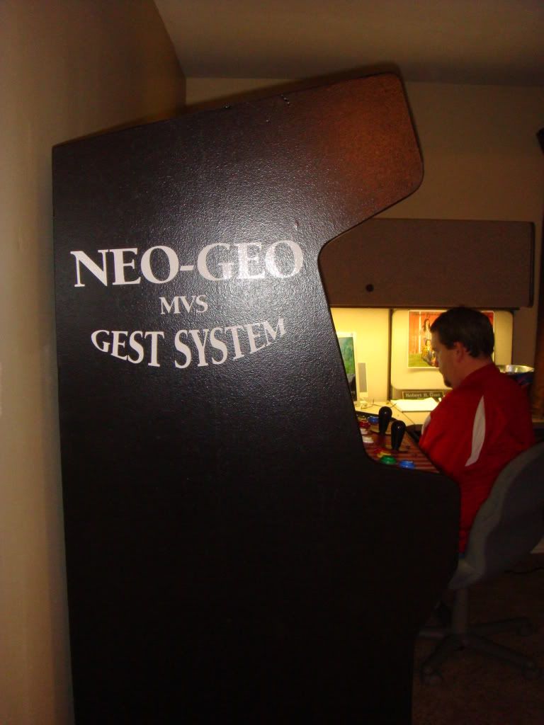

My custom side art.

I was going to move the joystick....I told myself "move the joystick"......I got everything done and guess what I forgot to do?

those joysticks also look awfully low.
The joysticks do look a bit low. You might want to make sure that the spacer is below the knob handle and not under the actuator. You put the spacer under the actuator on metal control panels but on the shaft below the knob for wooden CP's.
You can also use a router to cut out a 1/4" recess for the joyctick base to go into through the bottom of the CP.

Please redo your Control panel. They actually did try hard with your conversion and even put in the credit readers for both sides. It should really look as close as you can get to this. Only the right stick is in a correct position. The right buttons are even flipped. The A is always in a lower position.

The "Kids play with consoles" thing was a joke. I told the kids that this was our idea of video games. About the controls, I bought it like that and wanted something to play with. I know the controls need turned around but after putting $50 into an overlay, I think it will be a couple months before I do it again. I do like all the feedback and I don't take offense to any of it.

You should adjust the joysticks still, like someone said the e-clip isn't on correctly. they're really low.
