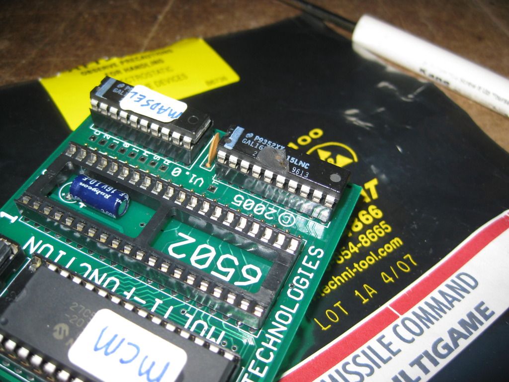

My dad called me recently said his Missile Command game wasn't turning on properly.
I pulled the power supply and tested it in my Star Wars cab - no problems.
Pulled his game board, and was a bit surprised to find a cracked IC on the multi-kit daughterboard. It's the one next to the screenprinted '@2005.' It's a 20 pin IC. The chip has a crack right through it, and a piece missing. Obviously a catastrophic failure. What could have caused that?
Can the chip be replaced?
I've contacted Braze for help...
Here's a pic of the damage. Oops. This folks, is why you should have your games plugged into a surge protector.
Scott told me that he can fix it, as long as the board's not been damaged.
I swapped in the original eproms, and the game seems to be playing OK. So off to Scott with the kit :D
