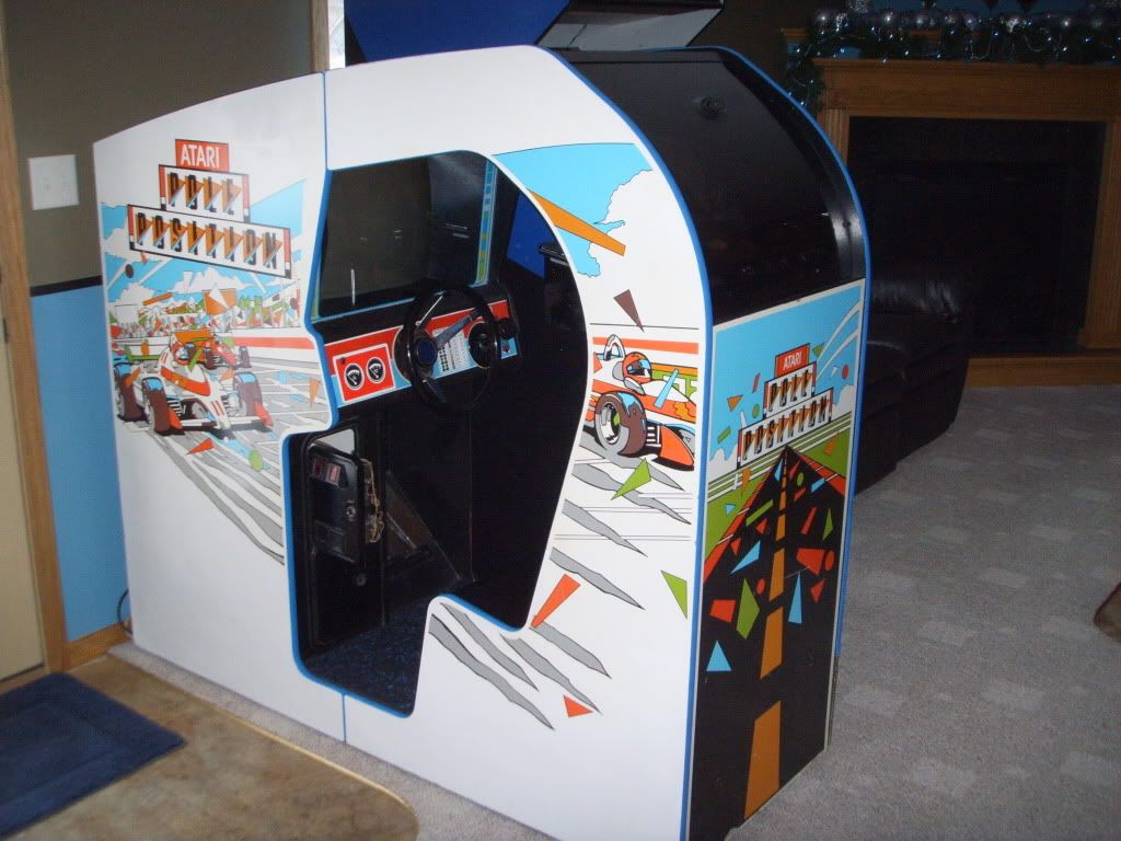

Yep, taping and painting will work, I did it to my Pole Position cockpit and it turned out really nice. Use a foam roller and rustoleum oil-based white in a satin or semi-gloss cut with a little penetrol.

WOW!!! UNREAL!! Do you have any before pictures?
