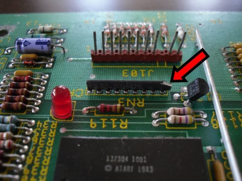

I reseated all the removable chips and checked every inch of it for anything burned out or showing a bad connection and nothing looks questionable except for one thing as seen in this pic.
Would this little chip cause my symptoms?

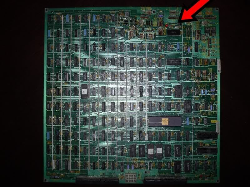

Here is it's location on the main board as it would be sitting within the cab.
Also my lower LED on the board is lit when the game is on but the upper LED as seen in the pics remains off, is this normal?
That's a resistor pack. It's probably ok as is. Is the white portion a continous white? Or does it have a darker spot in there? Measure the resistance between the 2 end pins. Should be 3.3k out of circuit. Hopefully, it won't be far from that in-circuit. I don't have schematics, so no guarantees. In fact I only have the Indy installation manual, nothing else...no system 1 or schems, etc. So can't help on the led symptoms.
How's that transistor? Are the legs all ok and not opened or shorted?
