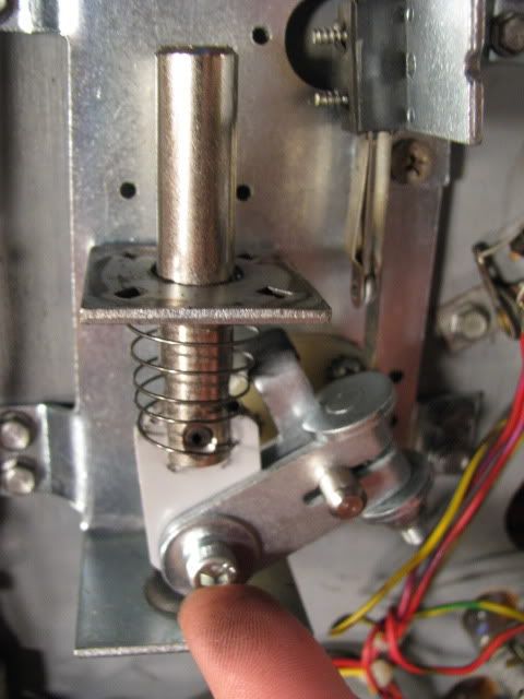

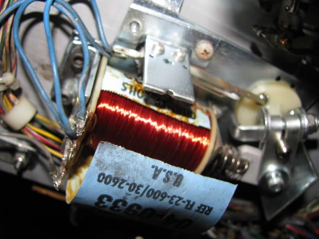

Paper does look a little brown, it has come loose I assume form the heat. This is the left flipper on Williams' Space Shuttle. The plunger is stuck inside the coil and will only move with some firm pulling/pushing.
As you can see, the whole flipper assembly looks fairly new.

I took apart the coil, definitely scorched - the paper is brown and I can't even get the sleeve out. So I think I need to replace those.

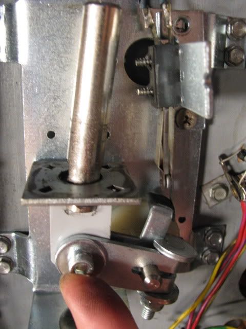

It appears the switch (EOS?) is staying engaged with the plunger in and out:
The picture shows a screw that holds the bracket for the End Of Stroke switch is missing, that allowed the switch to turn and be out of adjustment.
Install a new coil and sleeve then replace the missing screw, make sure the switch opens when the flipper is in the up position and made when in the stand by position or the flipper will not work..
eos
From your photo, it looks like your EOS mounting bracket is mounted with one screw. It shifted the home position for the EOS, not allowing the pawl to open it.
