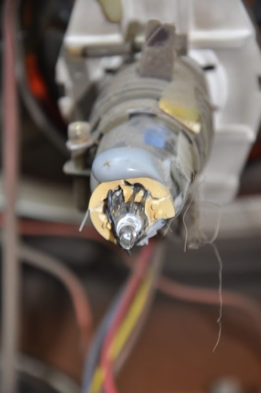

Bad news, my friend. I went back and took a closer look at your pics.
This pic worries me:
attachment.php
You see that little bit of yellowed plastic I circled? That's part of your keyway stuck in the neck socket of your neck board. That's not good. That tells me the the neckboard was smacked hard enough to rip it off the end of the tube, fracturing the keyway.
You don't NEED the keyway to plug the neckboard back in, but you'll need to be uber careful about two things:
  1. straightening out the neck pins again, provided they're all still there and not broken off
  2. plugging in the neck socket correctly, without being off by 1 pin.
Either way, you'll want to examine the neck board socket and pull out the pastic that's stuck in there. Then see to it about mending the neck pins. If any are broken off, likely the tube is toast.
Also look for any cracks at the end of the tube nipple.

OK GUYS...NEW RULE...ALWAYS TRY THE EASIEST OPTION FIRST...I spent 30 min trying to drill that lock out, but the door wouldn't budge...I look down...THE LOCKS BEEN BROKEN FOR YRS IT WAS SCREWED SHUT....10 seconds later...heres the pix...I have since streightened the pins.

also, after the pix, I pulled the piece of broken plastic out of the ring, as recommended.
As you can see, one of the "prongs" is currently free floating
I removed this piece of plastic from here
Eek. Here's what I see.
Your tube is most likely shot. Free floating pins means there's no way you'll ever get the neck board plugged back into the tube properly. At best you might get a working picture, but you'll lose colors as the pins finally break off, or the whole picture altogether if the focus/heater/ground pins are broke. More than likely attempting to plug the neckboard in at this point will cause more damage than good.

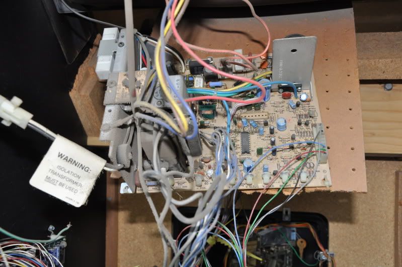

You need to find a donor TV for that chassis. Luckily you have a pretty common chassis for that monitor setup, a Wells Gardner 25" K7000 (or K7xxx variety. So as long as you find a 25" color TV with a 10 pin neck tube, you should have a match and you probably won't even need to swap the yoke.
Be aware, the knobs on your flyback are white - those white knobbed flybacks have high failure rates. Nothing to worry about now, but be aware of it. More savvy monitor folks don't like to see those white knob flybacks.
Really, someone mounted the chassis to a piece of breadboard?? Cripes, that cab IS jacked up.

Sorry to be the bearer of bad news, but you likely toasted the tube when you were driving home with it, or when you were loading/unloading it.

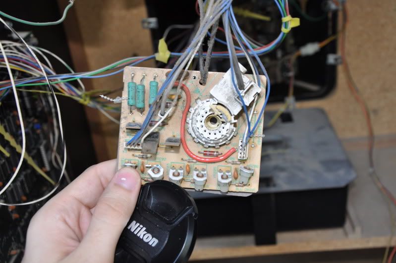

tube is lost likely gone man. Looks like the monitor is/was a wells gardner 25" k7000. I see at least one broken pot on the neckboard, so the chassis has some damage too.

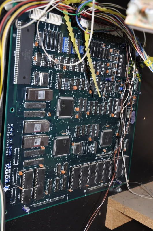

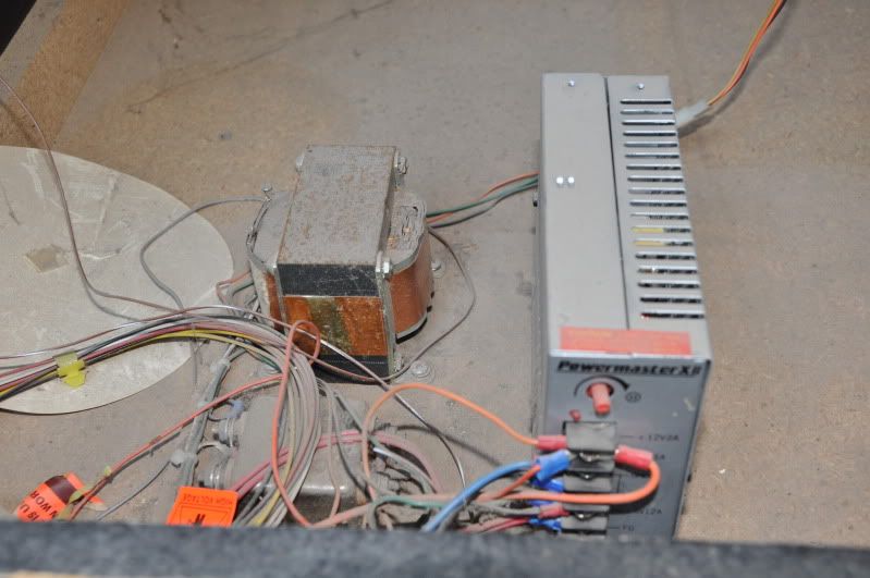

If you are going full on mame, save the game pcb as well. Its worth something to us folks. Same with the power supply and jamma harness.
