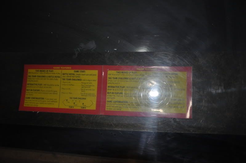

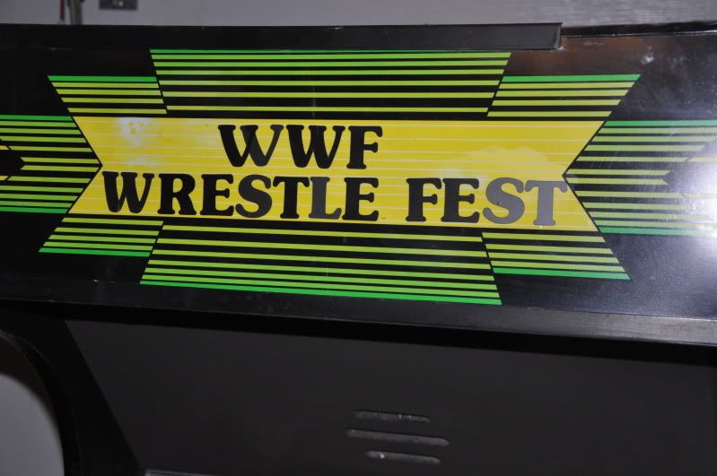

thanks guys, discharging the monitor has been made very clear to me dont worry lol here's pics of the unit as a whole (sorry they arent good, its still raining so i didnt have uch light to work with) along with the area where my problem is.
the instructions seem so...not like the machine...would this be on a dedicated one or would they be different?
