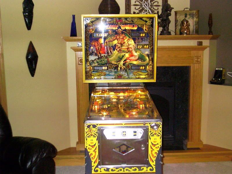

I've said it before, but I'd love a Paragon. I use to play one at the Dreamland Roller Rink's small snack shack/ game room back in '83-'87. It was next to a Gorgar and across from a Space Invaders, a Berzerk and a Robotron machine. About 6 years ago, I found it's predecessor, a '77/78 Bally Lost World. The pin has the same artist, similar characters and a similar layout/ playfield. Admittedly, I bought mine by mistake, thinking it was a Paragon and not knowing the difference at the time, as I had forgotten the name of the one I played, I just knew the Lost World looked pretty damn similar. I think I paid $900 for mine, un-shopped, and since acquiring it I have replaced the rubbers and the power supply and many burnt connectors with one of Tom Callahan's Deluxe kits. I have had zero problems since, except now I started losing the high score on power down, which must be a battery or MPU issue. Both pins are really gorgeous in my mind, but I think Paragon has a slight edge, being a little more refined. Here's mine, note the similarities to yours:

I would love to have that lost world sitting next to my Paragon.
