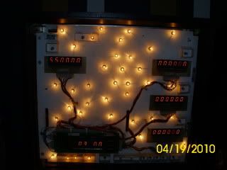

2. the #1 and #2 player LED displays, as well as the credits display and the ball number display do NOT display any of the very lower LED's.. (like the bottom segment of a zero). odd that its on all 6 digits on both players one and two as well as the credit and ball number ...

any way.. here are a few pics of my problem.. I "think" I got the 2nd ball in the right slot/space in the upper left as I was told..
now, on to the display..
I plugged the wire from player 4 (working good) into player 2, and player 2 displayed worked fine.. so I figures its not the display..

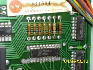

I look at the resisters on the board by the credit display as I was instructed.. on the left side bank of resisters.. I find #3 blown to heck...
so, I'll replace that one.. any one know the value of it?
Also.. on the right bank, the far right one looks a little burnt brown on the back side... dunno if you can see it ok in this picture...
look ok enough ? and ALL got pretty hot after a minute and touching them... didn't really narrow down which , if any, were hotter.. well.. that blown one on the left did feel hotter than the rest...
I suppose if I replace it and it all works.. I still need to know WHY it blew...
Thoughts ?

Those displays are famous for underrated resistors. It's possible something could be shorted to cause that resistor to burn but I suspect it just burned over time due to being underrated.
Here's some info on display problems:
http://www.pinrepair.com/sys37/index3.htm#display
I'm not sure of the values. You can find them with this:
http://www.elexp.com/t_resist.htm
I would use 1/2 watt or even 1 watt resistors as replacements. Those look like 1/4 watt. I'm sure it's all covered on pinrepair.com.

maybe I'll just put all new resisters in those two banks then if a bit age related and under rated...

It has been in my expirience that a display is probrably causing the resistors to cook.
Changing them is needed of course. After that I would leave all 4 displays un-hooked and plug them in 1 at a time feeling the resistors for a few minutes at a time. The bad display should show itself.

question: I know Lindsey gave the link to the resistor values...
Looking at the left and right bank of resisters... is it safe to assume they are all the same value?
On the left bank.. the first 3 obviously are not, and appear not to be meant to be the same as the rest..
on the right bank, you can see there appears to be one, 2nd to the last that is different...
Any one with a schematic can tell me if I should be ordering all the same , or if indeed there are some different ones mixed in ?

** Looks like if my research is correct.. I have a system 4 ? and the resisters are 10k 1/2 watts... and I found a picture of the same problem I got... so.. unless I hear otherwise here... I ll order some ( 10 k full 1 watt?) and start replacing.. I tested all of them and found one out of spec... the burnt one of course.. shows over 12k..

The only resistors in my area was radio shack.. and they only had 5 of the 10k 1/2 watt.. nothing w/ more wattage..
so I replaced the one that was obviously blown.. unplugged all the displays..
the credit / ball count worked perfect..
then I turned off and started to plug in displays.. #1 immediately did not work correctly.. and damn yes those resistors get hot checking them w/ my finger...
so, I unplugged #1 and tried the other 3.. all worked fine..
so.. #1 display is bad... I took it out to replace it..
the left bank of resistors are fairly hot now running 30 minutes.. the right bank is not..
but nothing blowing.. so far..
Big thanks to all and that link Lindsey posted helped alot...
tks... :) now to find a display ...

Your problem could be eather the display or the master display board.unplug one display at a time and see if the other bad one is ok.make sure you plug it back before moveing to the next one.If that did't show anything check the resistors on the upper part of the master display board,you will probley fine one or more burned.Their are 7 in a row on both sides 10K@1/4 watt,replace any burned ones useing 1/2 watt,if all that fails you probley have a bad 7180 chip,they are hard to find and are a little pricey.good luck. Ken
