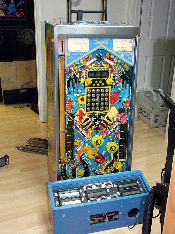

Got this today. All the wires were labeled AND there were even pictures to show you where every wire went, in case a tag fell off! Great game, very happy!
Guy was super Cool! thanks 2 Scott for taking the ride with me!

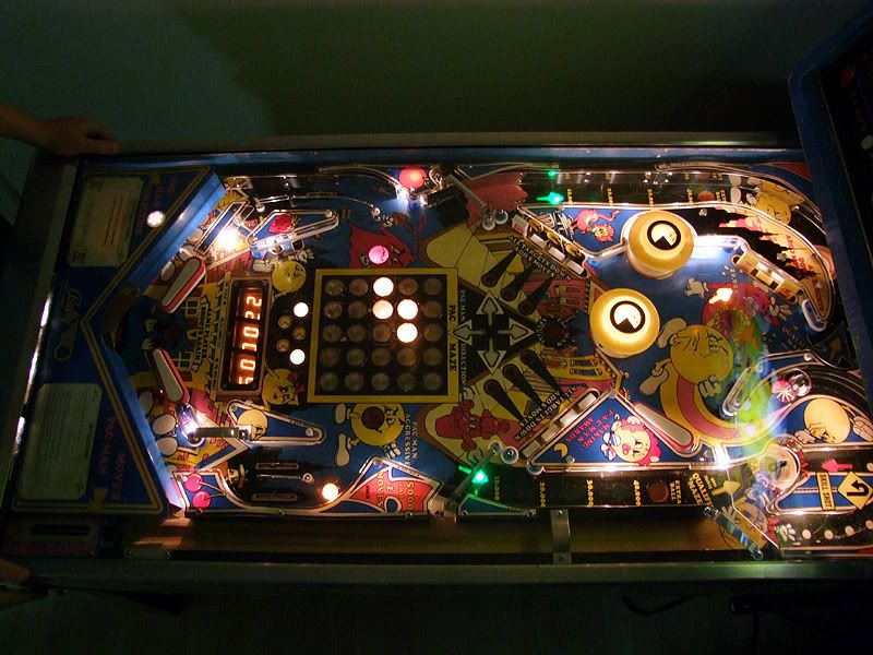

Tell me something...is the red light to the left of the pac maze staying on all the time? Mine does and not sure if its supposed to or not.

Have you ran the tests for the lamps? You probably have a shorted light driving transistor.
The light stays on even in the lamp test. Im thinking its a shorted transistor too since its the only light that stays on all the time, just figured I would check before digging into it.
