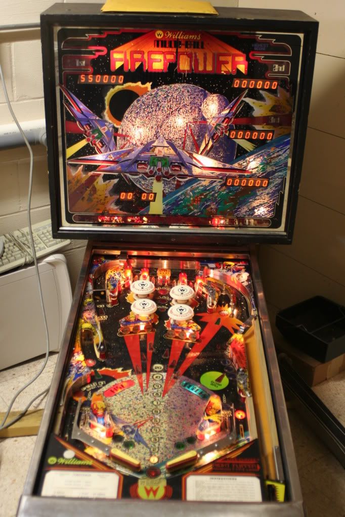

Okay! We're making some progress! Put all of the original roms back in, plugged it in, and woo hoo! I've got CPU controlled lamps! But no displays.
Then I opened the coin door and the displays came on!
I coined it up and was actually able to play a game. Flippers are very snappy ;)
Other than a few spots on the playfield that are dirty and the ball hangs up, I was actually able to finish a few games. Yay!
But I've got no sound :(

As far as the 'NOW' attention items, of course the sound is my primary concern. This game ain't no fun without sound....
The other item that worries me a bit is the left eject solenoid. When put a ball in it, the ball ejected fine, but then the solenoid fired another 10-15 times before it stopped. What do I do with that? Is my switch stuck closed?
Also, why does my coin door need to be open in order to get my displays to stay on? Shouldn't that be the other way around? Is my interlock switch wired backwards?
Nice to actually get some life out of this machine. Looks like replacing the 40 pin interconnect was the major issue needed here.
Thanks folks for reading this thread...and please keep sending helpful comments my way!
I promise I'll get some pics up (and a video!) when I get her 100% operational.

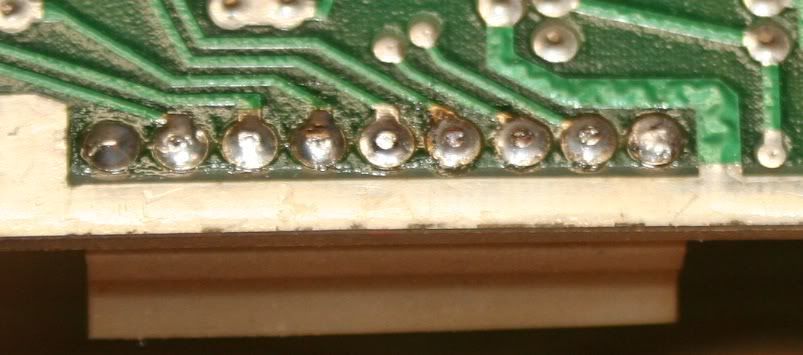

I know I haven't posted a lot pics in this thread, but this was a situation that I thought could be used as a learning experience for others in the future.
I am diagnosing sound issues with my firepower, and I decided that I'd better remove the sound PCB and give it a good examination.
Close inspection revealed quite a few cracked joints on the header pins.
I've attached a pic showing the pins that have cracked joints, with red arrows pointing to the obvious offenders. I will resolder them all, but I just wanted to document this for others.
This is why it's SO important to resolder your header pins.
With electonics that old, I hate reflowing them. Too much oxidation already, and you get poor contacts. I just get rid of all the old solder and apply fresh.

Working!!
Ladies and gentlemen, we have sound!!!
I resoldered all of the header pins on the sound PCB, resoldered the sound amp, and when I hooked it up, everything worked!!
I am so pumped. This table has been in pieces in my shop for months, and I wasn't sure I'd get it working.
I just have a few small details to work out on this, and she'll be ready to be buttoned up:
  1. Troubleshoot top line of the displays on P1, P2 and credit/ball-inplay
  2. figure out coin door interconnect / memory protect wiring issue
  3. Clean playfield, get new rubbers.
But for now, she's playable!
Just a followup post to my 'cracked solder joints' post from before.
As HHaase mentioned before, it's better to remove the solder and re-solder these pins rather than just using a soldering iron and melting the solder once again.
My trusty $10 Radio Shack desoldering pump strikes again:
Nice clean pads and pins. Next, I (crudely) soldered them:
Now I'm by no means a soldering expert, but I feel that these joints should outlast me. Or at least my desire to play this pinball machine, anyways. :)

So that's it! I'm calling this one done. Everything works!
A HUGE thanks to everyone who contributed in this thread. This was my first ever adventure into a pinball machine, and I have to say, I learned a TON! It was very rewarding to bring this one back from the dead. I know I have more 'preventative maintenance' things to do (like changing out IDC's & stuff like that) but that will come with time.
Woo Hoo! A free pin!
