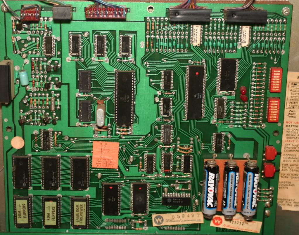

I was looking over the CPU board last night when I noticed something: it appears that IC9 and IC10 are missing? Is that right? I just looks like the chip legs are there, but no chips....
I don't know, maybe I'm crazy. See for yourself. Pic attached.

That's fine, it's just how a -6A board was assembled. They determined that the buffers at IC9 and IC10 weren't needed anymore on a System 6 board, so they put those jumper headers in there instead of the buffer chips.
