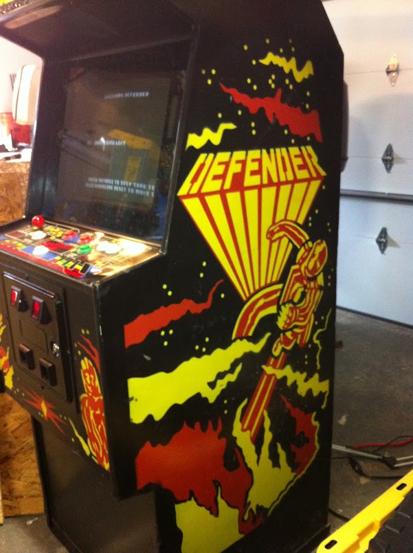

Oh boy...was inspecting the inside a bit more closely after lunch and found an unplugged connector. She now powers on, runs through POST, and runs through the attract mode! Still no sound yet, and I can't advance credits and get it to play. Could be the control board I guess, haven't taken the multi meter to it yet to run things down. Woop woop!
Some quick iPhone pics...better quality ones on my wife's camera but these should do for now.

There's a black wire that runs over to the 6 or 7 pin connector on the power supply, on the right. It provides the ground for all your coin door stuff. Since you put a switcher in, the ground isn't connected to the coin door anymore. That's why it won't coin up.
Thanks Lyons! I pulled the molex off the switching PS and connected it to the original. That let me click over some credits. I found branding on the switching power supply converter board which marked it as ArcadeShop.com. Looking at their site, this seems to be the one:
Now to find some documentation and see if they wired it in wrong, or something.
Only thing left to figure out now is the sound (still none, but the speaker gets hum if I adjust the pot, so there's power there) and the controls (non working yet, but there's continuity from the switches to the molex, I've tested that much).

It looks like the switcher is wired into the Isolated 110VAC going to the monitor. Only the monitor should be run off of this line. Tying the switcher into the 110VAC going INTO the isolation transformer might be a good idea.
