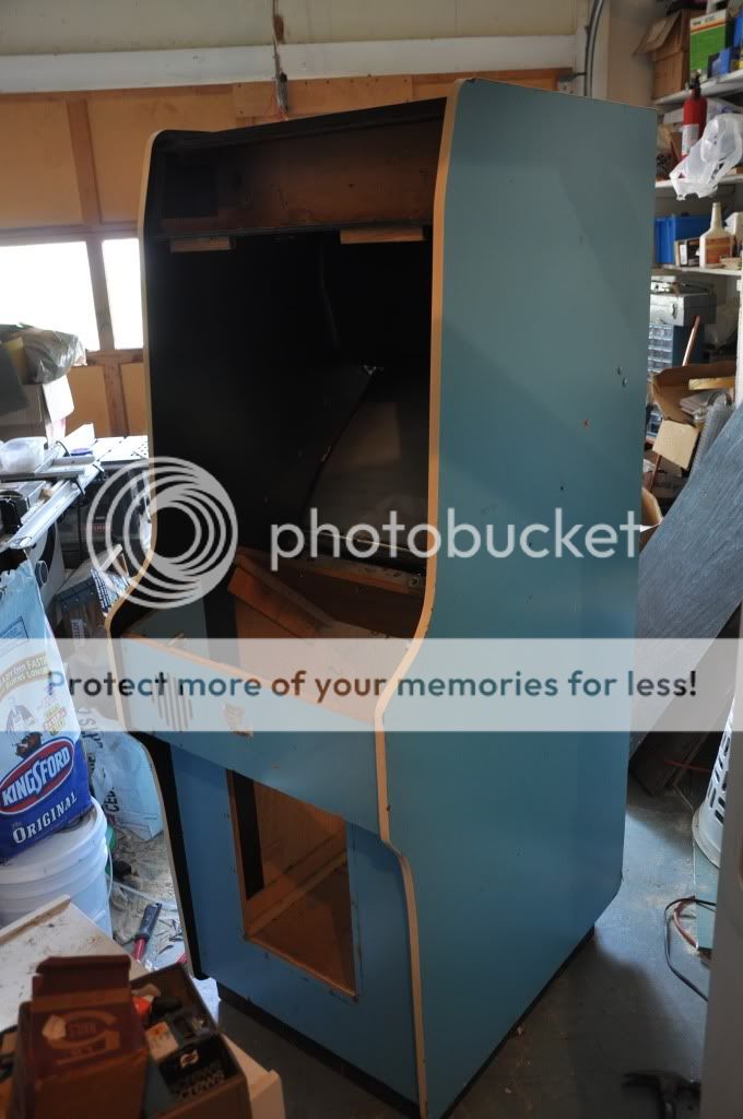

Looking good - it'll clean up real nice. That cabinet is nice and solid.

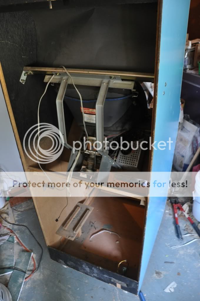

Just a word of warning, although I'm sure you already knew this. Whatever you do, DON'T plug that monitor directly into the wall! The power block that goes in the bottom of the game contains the special Nintendo isolation transformer, which outputs isolated 100v on those two outlets. You absolutely must use this to power the monitor. A standard isolation transformer puts out too much juice, and plugging the monitor directly into the wall with destroy several components on the chassis.

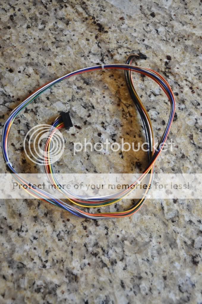

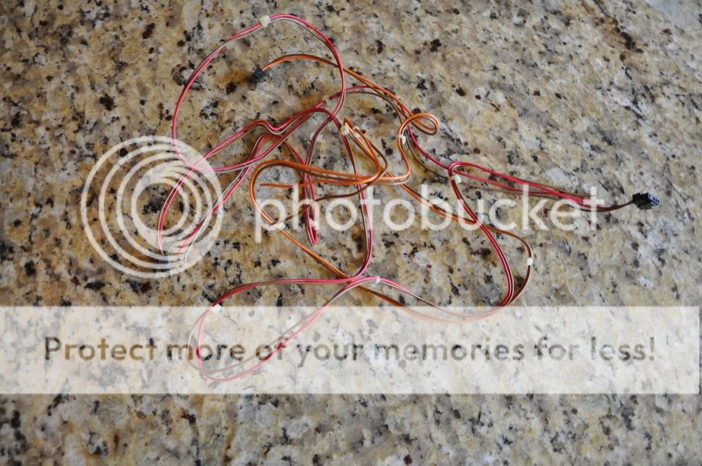

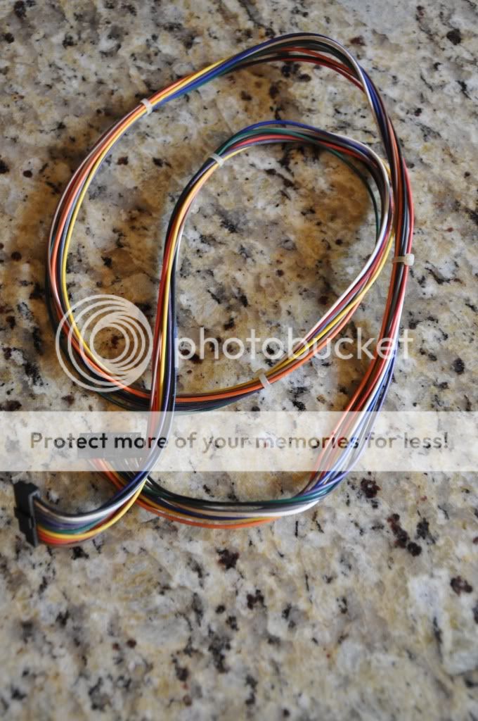

My donkey kong came with the original wire harness , but I do not know if the wire harness is for the four board set or the 2 board set. can you guys help. thanks
here is some pics
That'll plug right into either the four board stack or the two board version. Also, Donkey Kong Jr.
Donkey Kong 3 had an edge connector type harness. The edge connector harness is also backwards compatible, and will plug into DK Jr. and the two board DK.
Basically, Donkey Kong and most DK Jr.'s used that style harness - one cable for each function. There are two power cables (one for each board) that plug into two sockets on the power supply. There's a coin counter connector, coin switch connector, control panel connector, sound connector, video connector, etc. That style harness works great, but it's kind of clumsy, so they switched to a single edge-card type harness for other games (DK3 and Popeye, and I think Mario). The two board DK set has the edge connector on it, in addition to the multiple small plugs. Same with DK Jr. Only thing you have to remember, is that when using the single edge connector, you need an additional 10-pin interconnect cable to connect both boards to carry power from one board to the other.
So, if you get any original DK (or DK Jr.) board, it'll plug right into that harness, no modifications.
-Ian
