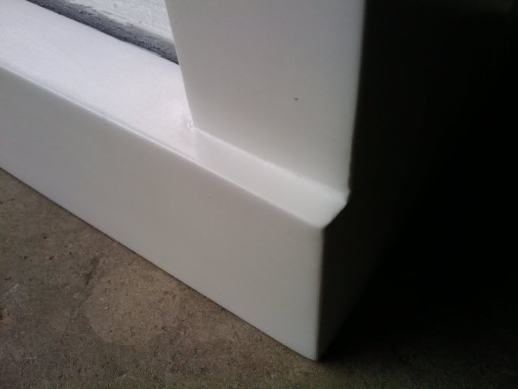

Couple of pics I just found on me phone:

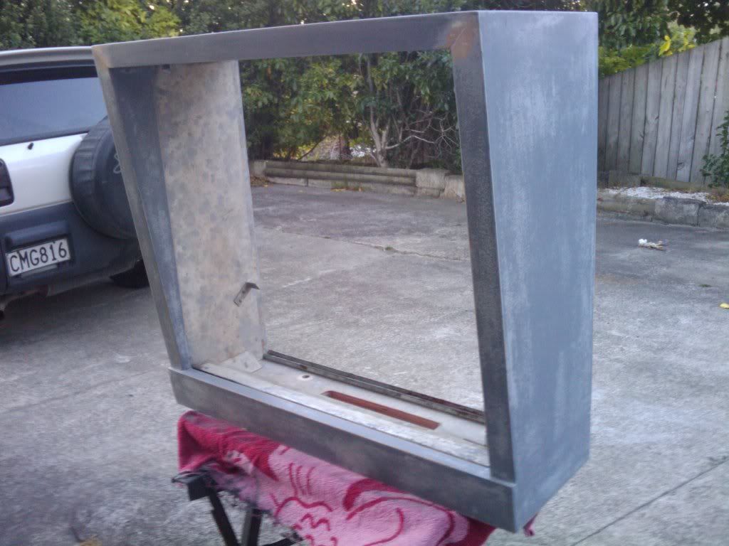

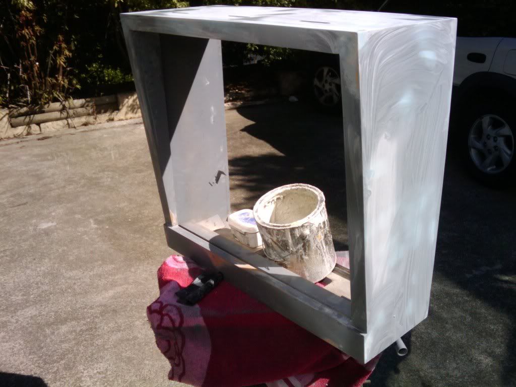

Sanding and priming the headbox:
Getting flatter and flatter!

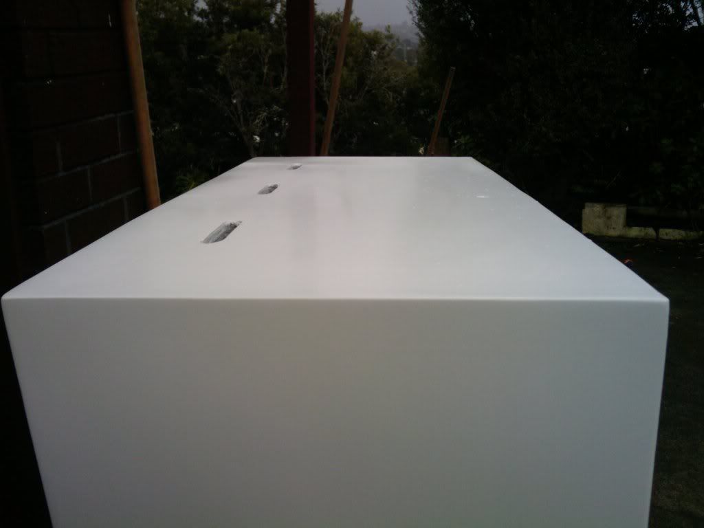

I was happy enough to blow a coat of white on it to see what it looks like:
A few imperections also show up when you give it its first coat so I need to fix them up before the finals. What you see there is about 2 hours of solid sanding and priming

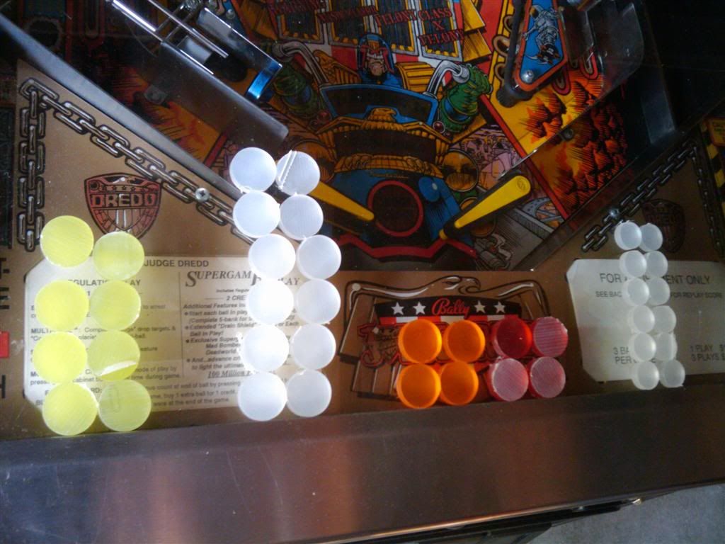

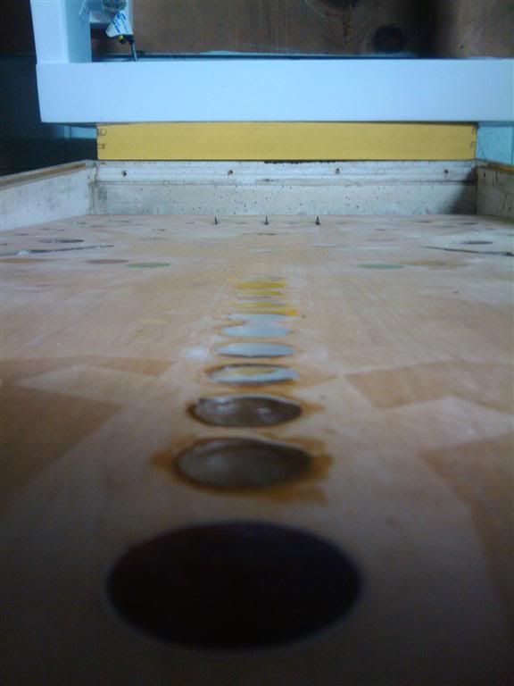

I really need to get this done so I did a bit more over the last week or so. So you may remember that I had some new inserts cut:
In this shot I was testing the colour scheme:
Sunlight shining through:

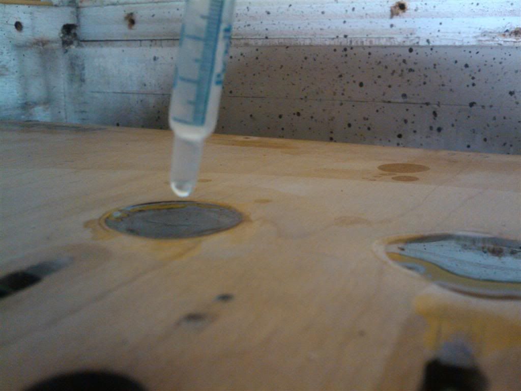

Some of the inserts sat really nice but some went in about 1mm deeper. I suspect that was a factory mistake as all the new inserts are the same thickness so I have had to build up the difference with some lacquer.
I used a syringe to suck up the lacquer and apply it to the inserts:

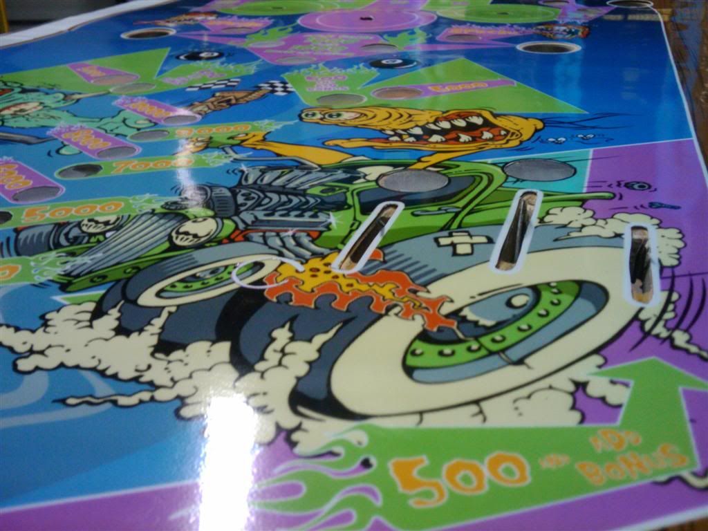

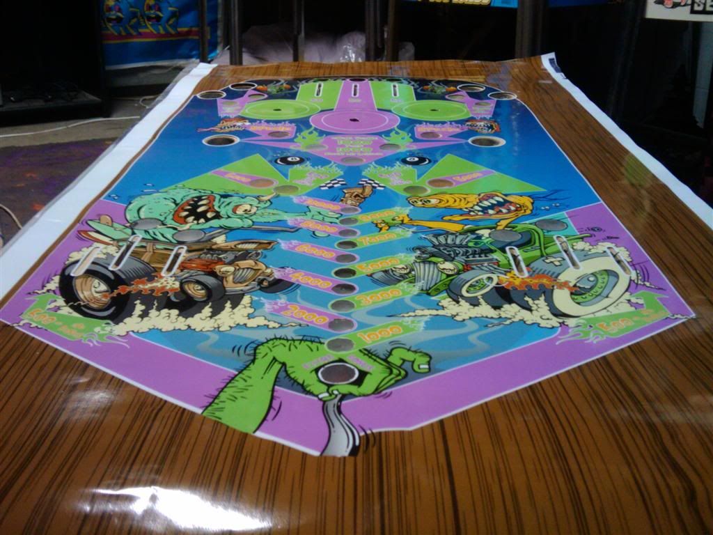

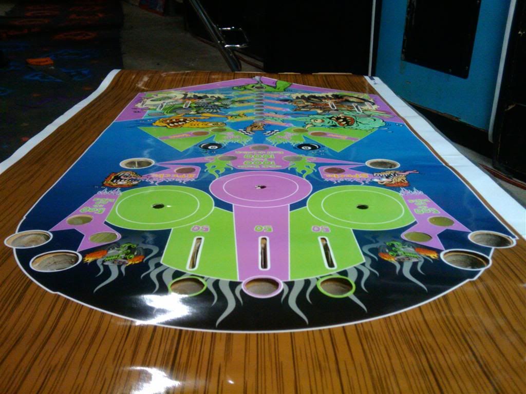

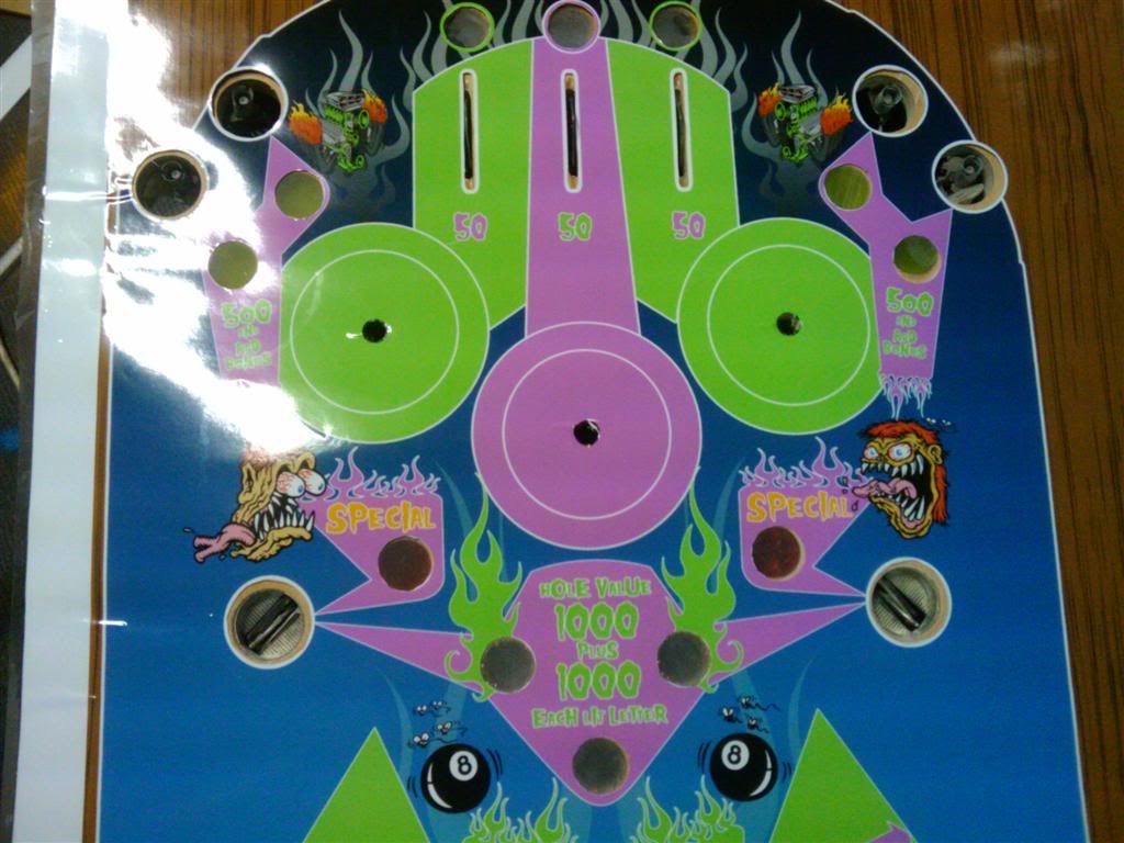

I have a one small piece to fix up and then it can be sanded and clear coated ready for the decal. I did another test print in full scale to check registration.
Of course there were mistakes
Targets, left inlane and kickouts need adjusting:
The rollover of the far left is wrong too:
All good here too, only thing to fix is the RHS 500 and bonus
Don't worry here, I bumped it :p
It seems no matter how careful you check there are always a few out.
