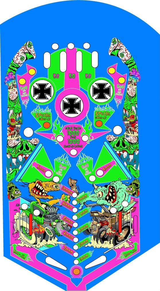

So its all happened pretty quick since the pinball arrived a couple of days ago. I searched the web and was lucky enough to find someone who had a NOS (not installed) playfield and I got him to take several high res images so I could get a feel for the layout. He sent the images through, I stitched them together in photoshop and then moved the image to Illustrator. Once in there I measured my playfield and transformed the image to the correct size. Now I have a very close (within a couple of mm's) background to work with.
So first thing to do was to draw the location of the inserts, lane guides, plastics, drop targets etc etc. After a short time I ended up with this image:
I think a couple of things are out (hard to judge by photos) but hey, once I acutally pull the playfied down to strip it and start preparing it I will get the scanner and tape measure out and get it 99.9% spot on.
So there you go, its underway.
Right at this point I have just about finished the playfield design. This is where I am at:
Not bad for a couple of days :p

This is going to be a very cool project!
Here is my constructive criticism:
The big plastics are too busy. Also, you should have different art on each plastic.

Thanks. I am hearing ya about the plastics being too busy. I will do a test print before I make any changes.
Also the plastics that are currently on there are a mirror image of themselves whihc is fairly common even on todays machines.
How are you planning to get the art on to the playfield?
3 choices:

I don't think the iron crosses on the pop bumper caps goes with the rest of the theme. Perhaps some UFO's or something? Or big alien eyeballs?
Sweet I will change the crosses to eyes :D although there is supposed to be a score of 100 points on the tops of the pops. I am looking in to some translucents ones as well so they may not need anything.

I personnaly think that you should add some more cars and a little less of the aliens. The rodas look cool and i can see the side of the cabinet having artwork done along the line of Nitro Groundshaker with a cool rod on the side. Maybe find a way to use the inserts as part of a car, like wheels or headlights so that they stick out when that insert is lit
Aliens? Heh. They are Monsters. This whole theme is based on the bubblegum and collectable cards drawn by Ed Roth and others.
Man thanks for mentioning Ground Shaker. I had never seen that before! WOW. Its beautiful. Awesome. Yeah something like that would be great. I have a few more monsters up my sleeve so may use them on the side.
Yeah I was told I should use car parts on the drop targets. I have drawn some just in case.

Removed Iron Cross and added the pops score (same as original machine)
Added Checkered Flag
Changed plastics
Added the hand and shifter
