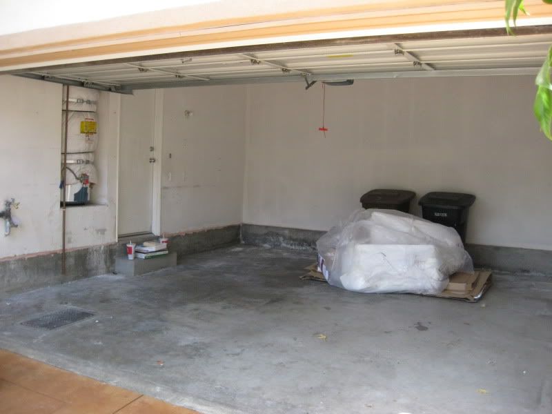

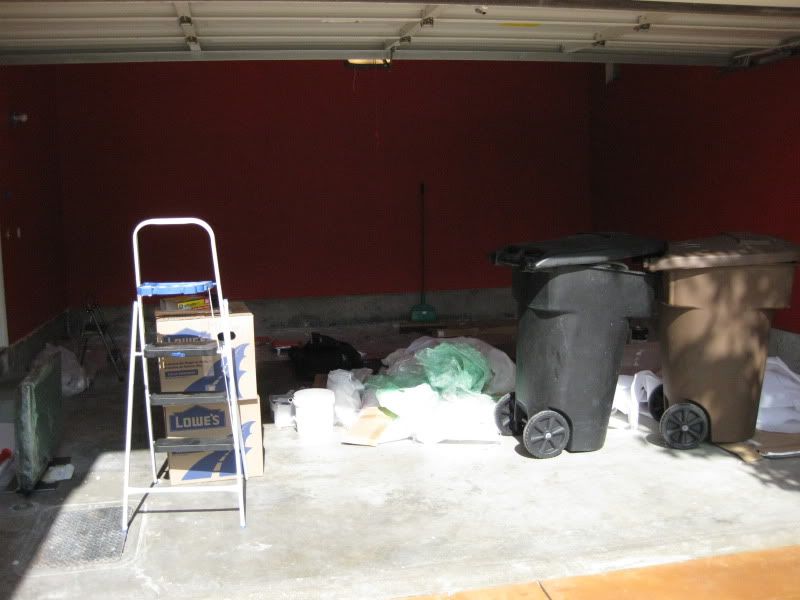

i bring to you my new "Blank Canvas"
wow, the last couple of weeks have been nuts! selling our old condo, moving into a house (to be closer to my wife's family), and finally getting the new garage ready for my new Atomicade.
luckily, the new buyer of our old condo is giving me 1-2 extra weeks to keep my games @ my old place in the garage. this is giving me the time to properly plan out and "dial" in my new garage set-up.
so far i have picked out a paint color for the garage and have rolled one coat of paint. big thanks to DAVE (vectorinvader) for helping me out along the way. thanks to you bro.
just looking for input/feedback from you guys....
what kind of style of gameroom do you like?? carpeting?? vinyl floor ?? wall art?? minimal?? stripes?? lighting?? mirrors?? etc...
more pics to come as i make some progress :) chris
Looks like a hell of alot of oil on the LHS , just be careful if you are going to get any coatings on it ,, absolutely nothing sticks to oil , so you need chemicals to purge it out , that can take a few days of applications .
Then a good grind to remove the top layer off for a key .
I do Epoxy floors ,
But a vinyl guy will tell you similar for his glue prep .
If you ever go these options , i can help with the product , and to find it`s equivelent in the USA .
That is if that is oil i can see , not dirt .
Good luck .

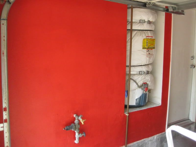

I would try to find a way to move the over flow pipe on the hot water heater and maybe get a pan under the water heater. If your going to your games near the hot water heater.
That's an emergency blow off, not an overflow. Unless something goes catastrophically wrong (like the burner doesn't shut off), nothing will ever come out of the pipe. So, don't worry bout it.

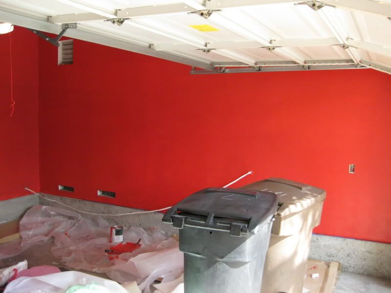

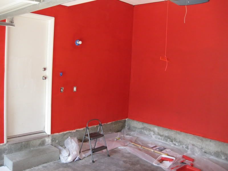

ok, so i got the second coat of paint on yesterday on "most" of the garage. i ended up going with a loud 80's red. again, big thanks to davey (vector) for his help with the first coat of paint.
just trying to figure out what carpet/flooring color would go best with the red walls. maybe brown, dark grey or blue??
i never realized how tough it is to paint a room red. lots and lots of coats of paint@!
In doing maintenance on apartments for 25 plus years. I had 4 fail on me nothing explosive but there was one that did gush. All failed due to the high mineral content in the water which can be found in the orange county area depending on where the city gets it water. Since he is living in the orange county area. It's a simple piece of mind thing. If you have low mineral content water, this wouldn't be an issue and I wouldn't have brought it up but since his new place is in the orange county area. It was something I thought should be mention.

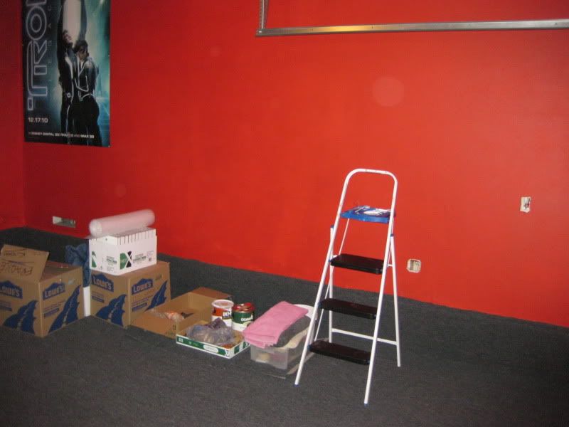

ok, finally got some more work done in the garage!
picked up a couple 12 foot rolls of the industrial strength dark grey carpet over @ home depot. bought a couple extra feet to cover the "wrapped" area towards the bottom of the red walls.
big thanks to davey (vectorinvader) for all his continued help. he's got mad skills with framing and such. helped me big time to get the middle seam done (total pain in the ass). also wrapped the carpet on the step area to give it that "clean" look. we used that double sided gorilla carpeting tape which really helped out alot. there are a couple of small flaws, but overall very happy with how it turned out. oh, my youngest loves runnin around in there too.
next up is hanging the artwork/lighting and then the games will follow. so far just been having alot of fun with this whole process :) chris
