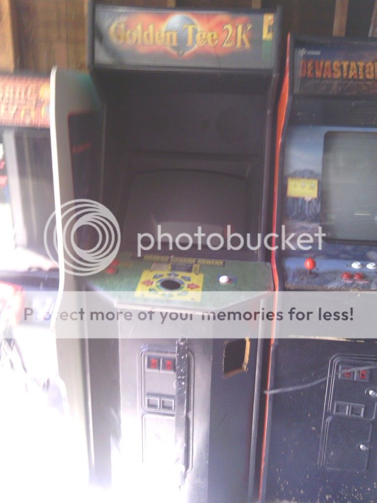

I guess I should start this at the beginning. I first had picked up a cab for $20 on my way to work one week. It was originally a Smash TV 25'' Cab. Which has been turned into a few different games in it's life time. Mortal Kombat and GT2K.

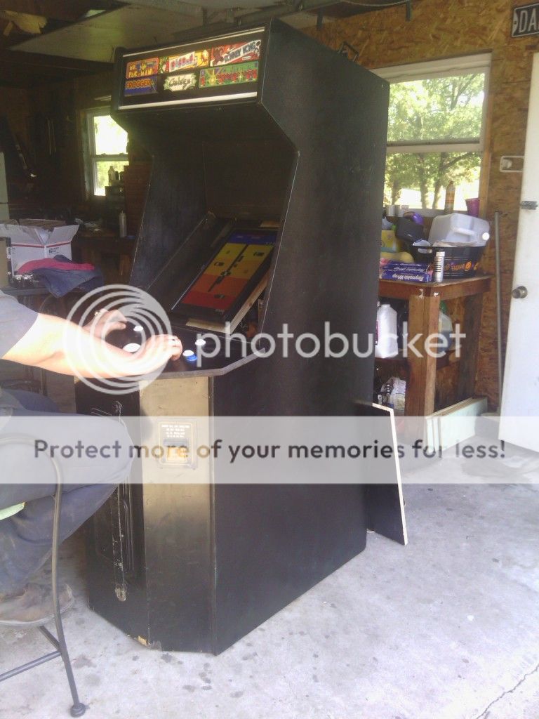

Monitor in it, was totally shot. Game board worked, but has its issues. So I decided to build a multicade (60in1) out of it. Trackball and such just to have some fun and give the game some life. There is no way i'm skilled enough to convert it back to a Smash TV, let alone the funds involved were beyond my means. So please don't hate on me for it.
Without the new plexi installed but just about finished.
