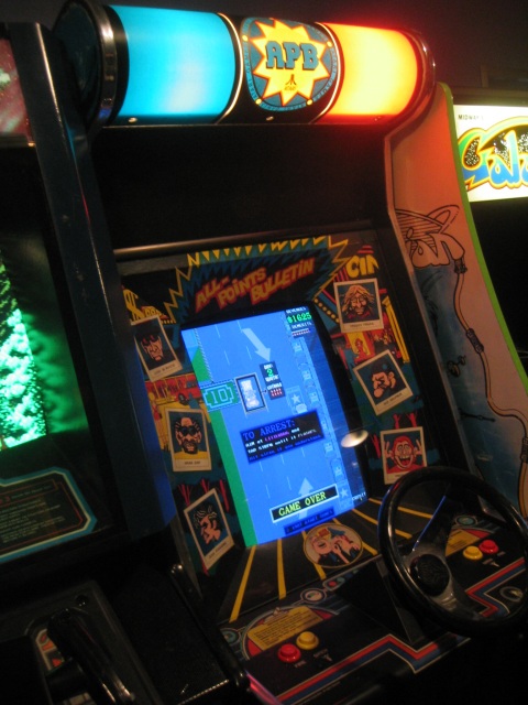

My A.P.B needs a monitor,recomendations please?
sohchx - you will have this problem a lot with your taste in games. Paperboy, 720, and Marble Madness also use med res.
I thought about buying an APB a few days ago. As soon as he said really dim monitor, I didn't want to mess with it.
Marble Madness is standard rez -
System 1 - standard
System 2 - medium (APB, Paperboy, Sprints, 720, Hard Drivin')
Marble Madness (as stated above) is a System 1 game. System 1 uses a standard resolution monitor.
Here's what I've done for the same problem. I got this converter :
...and a VGA screen.
I'm very happy about the result :
All the details right here.
Whaaaaaaaaaaaat!!!??? Very nice!! Where can I get the The 24khz to 31khz converter from, and what is the size of that PC monitor that you used?
