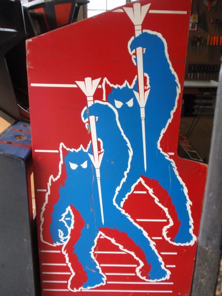

Another dead row purchase. This one has a silly story behind it. I was checking out and settling my bill for my $10 Karate Champ, when a frantic Chris ran up to me and said, hey man, they just passed the Deluxe with no bids, didn't you want it? I suppose I said, walked back out into the warehouse, offered them $25 (the auction was over) and they accepted. Got it home, cleaned off the mold and dirt, and here's where it stands:
Not too bad, but I still ordered the Stencil kit from Rich and found a complete working boardset with Braze's 8 in 1 installed. This unit powers up, but I only get a rug pattern and some humming. At least the monitor works and the Colored overlay is in good shape. I'll be doing a full restore on it, starting this weekend. Glass Bezel is in really good shape. One question. Did these come with the same Black Light Moon that Space Invaders used?

Stencil kit? That original sideart looks beautiful. Is the other side messed up or something??? :confused:
What he said.
Plus, damn that's a great score for $25! With a Braze multi kit too! Congrats, that's gonna look awesome in Galaxy Blue...
Yeah, I also don't get why you want to redo the artwork. Looks pretty damn good from here. Unless there's some damage that doesn't show in the pics. The cabinet isn't watered or anything, is it?
I would just touch that up personally, the side art looks really great, at least in the pictures you posted. Also, I hate you ;)

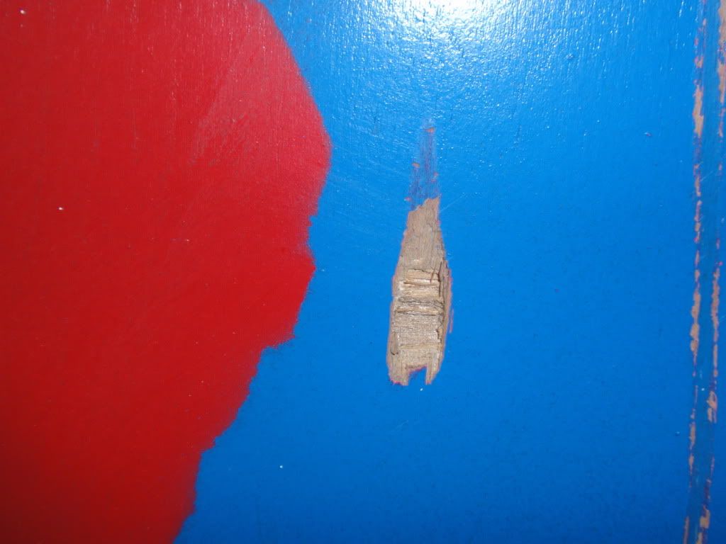

I got a partially rebuilt power supply along with the boards and multikit from the same guy. As to the restencil, I have been thru this before on my Moon Patrol and Berzerks. They look OK, and probably would satisfy most folks that think restoring games is too much work, but when the paint is flaking, the plywood is delaminating, big gouges and corners that need filling and rebuilding respectively, it is just better to redo the whole friggin' thing. Trust me. Plus I still need to bleach and wash out all the mold and mildew I can still smell. I have to drill out the back door locks before I can get in. Here are pics of the other side:
