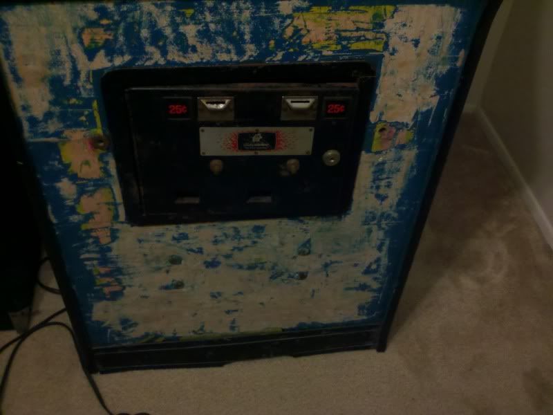

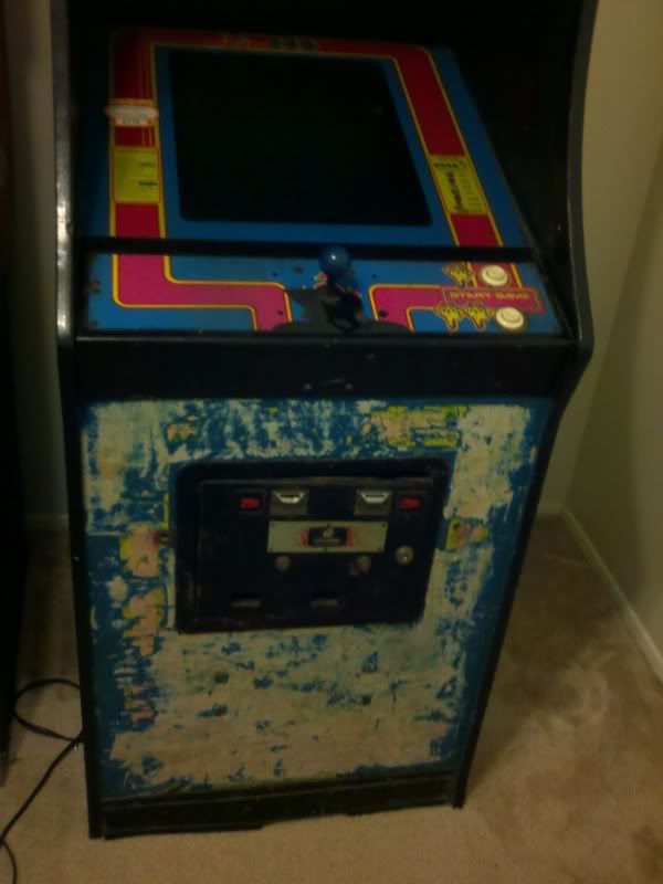

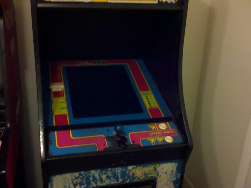

He had it in his open garage and a quick inspection showed that parts of it were rough but it was worth the money he was asking. The coin door is junk, it needs to have the rest of the body prepped and some small places need bondo, the joystick is non-original and totally worn out and the marquee was faded. I noticed that the power cord had been repaired with electrical tape.

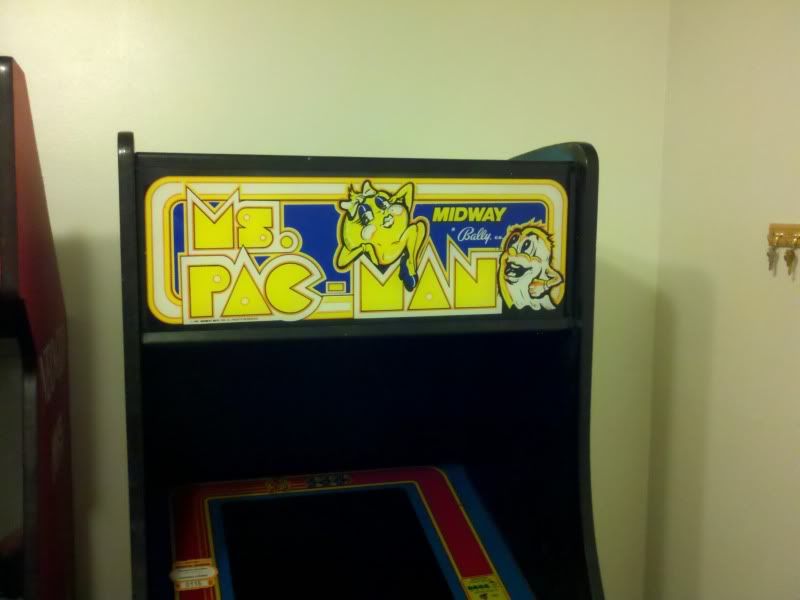

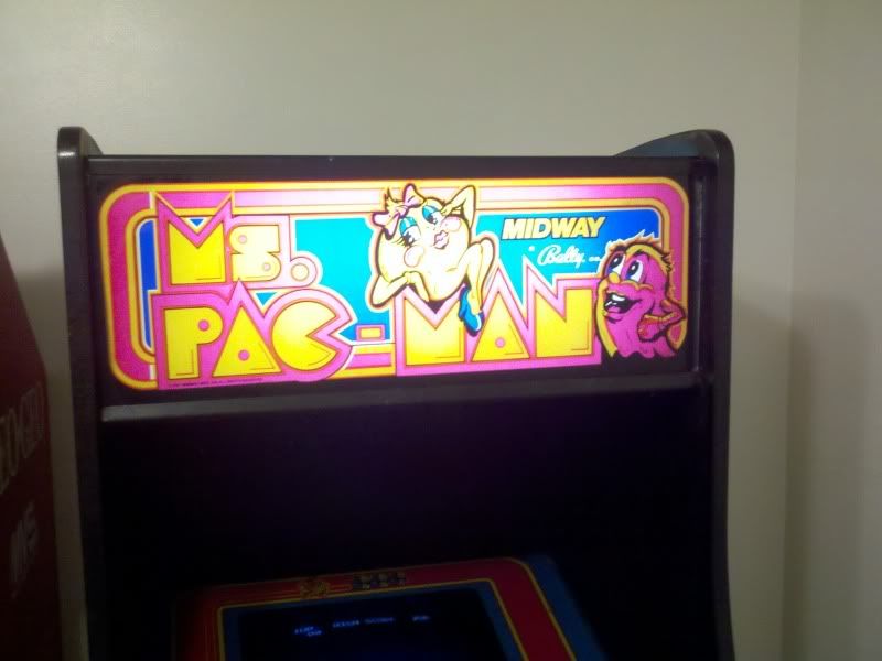

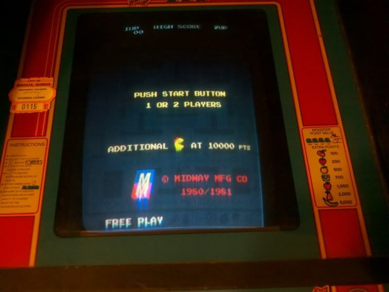

The screen had significant burn in and as you can see in the pictures there is some smearing underneath the characters and logo. I have a non burned in monitor that is just a few years old that I will probably toss in it. The joystick needs to be replaced and and it needs new CPO artwork. This should be an easy project. I already replaced the marquee with a non faded one I had. A few pics:
You should be able to touch up that sideart with a sharpie ;-)
A cap kit is a good idea, but not absolutely necessary judging from your picture. I'd say the brightness is up too high and possibly the blue is over-driven; both are easy enough to adjust out.
Before you go crazy adjusting the monitor, make sure to remove the tint screen and clean it really well along with the front of the picture tube. I like to use Mean Green from the Dollar Store since it cuts through the cigarette tar better than anything else.

I played with it a bit and turned down the brightness and turned down the blue. The smearing is gone but the reds are still washed out a bit and have an orangish hue as seen in the following pics:
I will have to mess with it some more when my wife is around to help.
