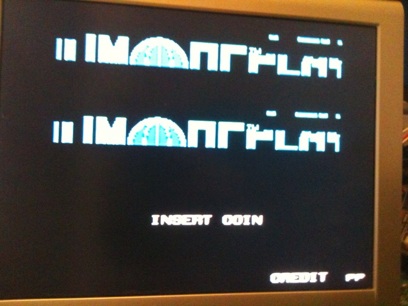

Have this nice small MV-1B but it has a graphic problem, I have so far changed the video ram 5 and 6 but its exactly the same
it boots ok but when setting dip1 is set then i get this, a good pic taken from a mv1fs is shown for comparison
My bad MV-1B

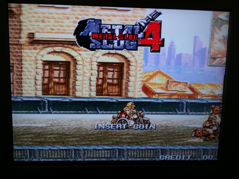

here are screens of metal slug 4 when game is running
My Bad MV-1B

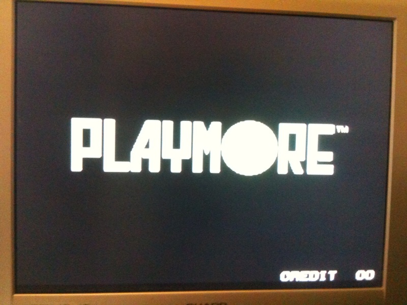

and also
My Bad MV-1B
The screen should look like this. pic from a good MV1FS
as you can see a bit screwed! does anyone have any sugestions on what to go for next? there is no circuits online so a bit stuck!
help!!!

One MVS cart slot has holds two boards--a top board and a bottom board (or front and back board depending on how you look at your NEO cart.).
In general, the top cart board is the program board and the bottom cart board is the graphics board.
Your problem seems to be with data communication, either to or from, this bottom cart board (somewhere along the bottom half of the cart slot).
IMHO, it looks like you'll need a probe to find out which chips and data lines are not communicating correctly with the bottom board.
Given the compact, hoizontal design of the MV1B, this looks challenging.
But the idea is to work your way from one side of the bottom cart slot, to the other side, checking data communication. Look for a faulty chip or line on the board side--and fix it.
