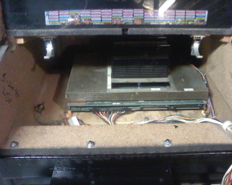

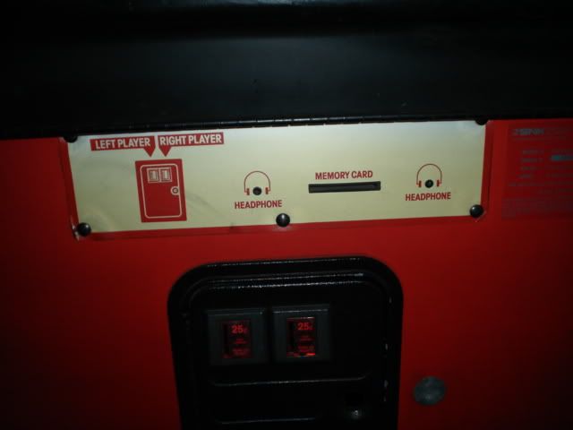

I recently bought a MVS 4 slot off an operator. On the front of the cabinet there are two slots for a memory card, one one the underside of the control panel, and the other on the front between the control panel and coin door. This one has a label with and arrow. The one on the CP has a cover, removed in the photo below.
The slot is not connected to the MVS and there is no cables. Same goes with the headphone jacks. Are these normally connected on an MVS, or is it some kind upgrade that operators need to buy?
Also is my the MVS unit installed the way that it came originally? See photos below:

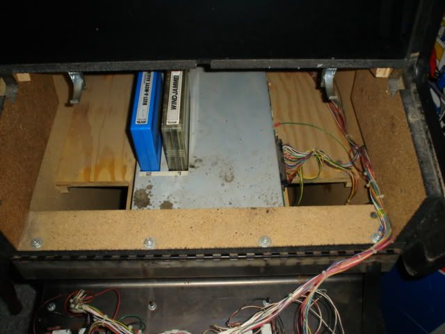

looks like your cab originally was a 2 slot cab
the 2 slots mount like this
this is because the 2 slot board has the mem card reader and headphone jacks built in

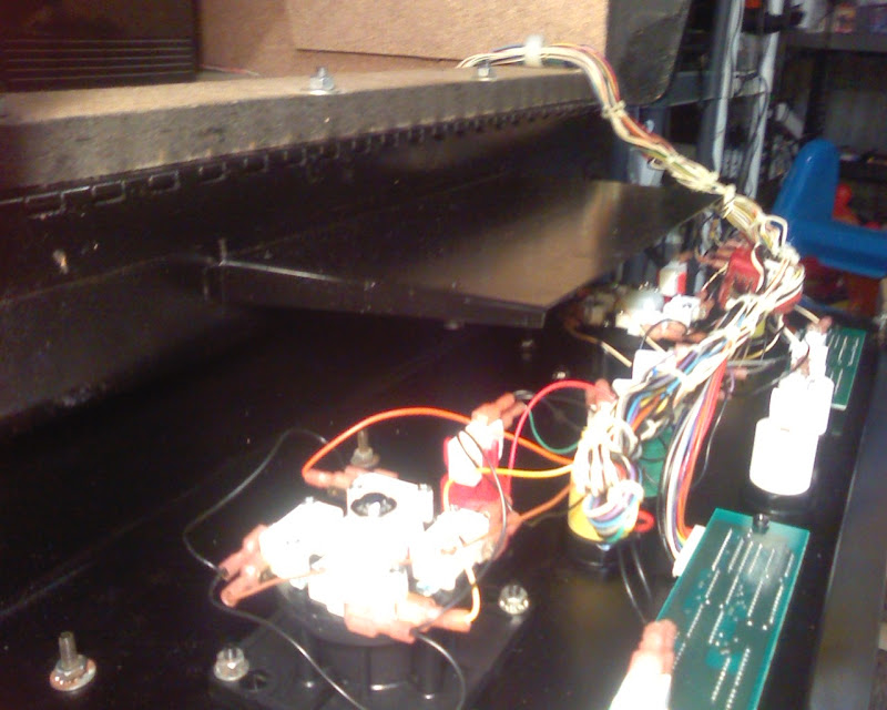

on the 4 slot there would be a metal shelf that is part of the metal cp
on thhis shelf you would mount the mem card reader and headphone jacks
then they would attach to the 4 slot board by a cable that hooks into one of thoes ide looking connectors on your board (the other ide style connectors are for the el pcbs that would light each mini marquee as it was chosen)
it would seem that oyur cab is a 2 slot cab with a 4 slot cp (or it was modfied at some point)

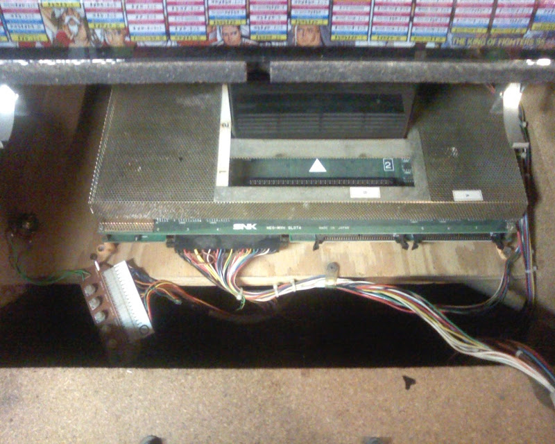

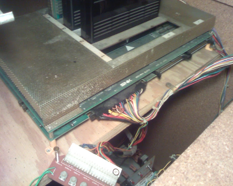

Wow weird, my CP has the shelf and the cabinet has the slot.
Also the weird thing is that my shelf does not have that center piece that a 2 slot would mount as in the photo you attached...
When I look at the serial tag it does indeed say that it is a MVS-2:
So the question is where do I get the cable to have a memory slot? Also do the 4 slot cabinets not have headphone jacks?
i have been thrue 4 2 slots (buy em cheap restore em and then sell high) and have never had a mem card but you still gotta have the reader and jacks to make it a real neo
Those cards go for bucks and are pretty rare on ebay. You can see the board and cable up to $100. My 6-slot didn't come with one either. Anybody ever use the memory card or headphone jack? I've never tried. You got me curious now. I might just do that tonight.
