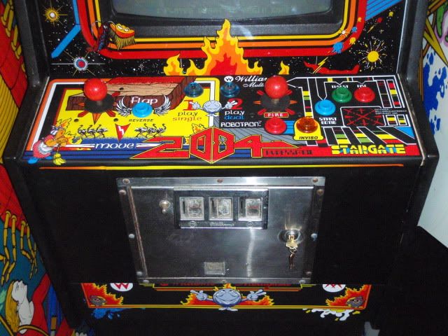

I made a MW CP for my Defender cab from scratch based on the CPO from Back to the Arcade (http://www.backtothearcade.com/index.php/categories/multi-williams). Below are some pics. I still have the coardboard template that I used and can dig it up if you need the dimensions. I used 3/4" playwood for the CP, a spare 8-way Wico leaf joystick and buttons ordered from TRBR. The spacing was definitely tight, but everything fit in there.

Here is how mine turned out
I used the cpo from Rich at ThisOldGame
I used 2, 4inch leaf wico's flush mounted to the bottom of the control panel, the 4 inch sticks are just tall enough to play Robotron comfortably and short enough to play joust and Defender, only thing I had to do was grind some of the plastic button nut retainer for the player one flap button.
