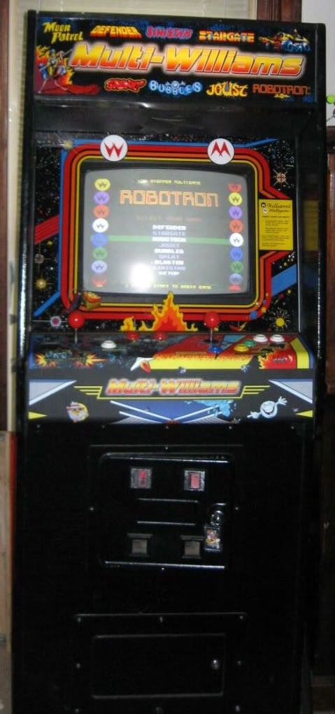

I use the Arcadeshop metal CP and it houses microswitched buttons. Not too bad a deal IMO, but for certain, installing leafed Wico sticks is the way to go. I too could not find a Phoenix CPO so I just went with the Arcadeshop one:
I still need to add change the t-molding to red, and find a new speaker grill.
Also, yes the link I provided is inkjeted; it arrives in a tube. Sorry to not have pointed that out. But as Prevuously mentioned, it is a nice substitute. I should get one for the above Stargate cab, but I dunno..
Good luck with yours! It is a fine addition to any game room!
