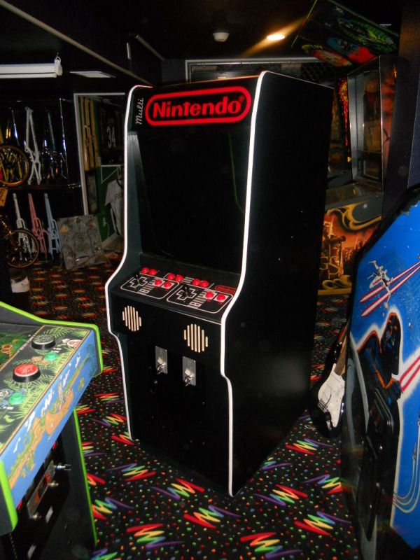

Spent the last few days accomplishing this. I know there are some strong anti-Mame guys here, but I feel this was tastefully done...
Cool vid. I actually had thought of doing the same thing with the VS Hogans Alley cab I had before. But since it's only me mainly that enjoys the games, there was no point. So I kept that all in my centralized (temporary) Mame cab. Ended up trading the cab for a monitor, and well atleast the cab will now be with someone who will treat it right.
I may have missed it, but I am going to ask anyways, how are you adding credits when playing the VS games?
It's set up for P1 or P2 Start to act as Start AND Coin. When you press either button, it coins up and/or starts the game. Only have to use one button that way.
Great thinking! Did this as well:
You don't need to have a separate power button for the computer, you can jumper the pin on the atx connector so it will turn on with power. Also some bioses can be set to do this too.

Where is the How to on this?
Also does anyone know how to solve my problem, I have the super mario 2 and 3 playchoice on my mame machine and if you Tab and get into the game settings you can set the game to Full screen without the green instruction screen on top but when you exit it switches back to two screens next time you load the game. Is there a way to keep it Full screen?
