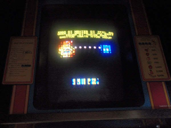

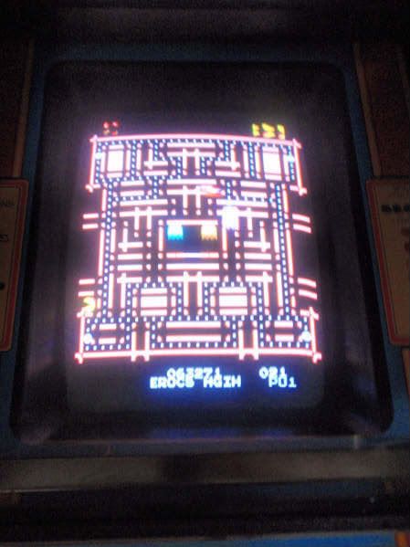

It looks like there's more going on though as sprites / characters are flipped vertically. Most likely a bad XOR gate ('86), multiplexer ('157) or a bad attribute RAM..

Yeah- it's not a monitor problem or anything with the yoke wires.
Something is whacky on the board.
unless you're the one selling it, or have seen it, we don't know that for sure. The pics in this thread were from somebody else who mentioned a problem they had that could relate to the description given...
The characters are flipped individually... It's on the board and it's affecting tile-mirroring.

Well, I haven't seen a picture of the game in question, so I wouldn't know. The description given from the OP does not indicate that either...
Ahh- got it. Phet was just offering assistance by describing an issue with HIS board. So, you're right. Based on the original poster's information, it could just be a mirrored image.
