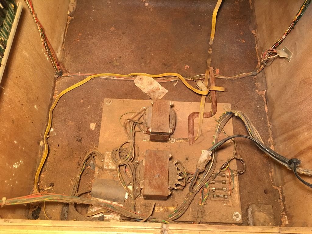

Here is a look at the Power supply:

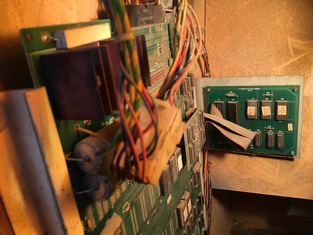

Here is a look at the board set:

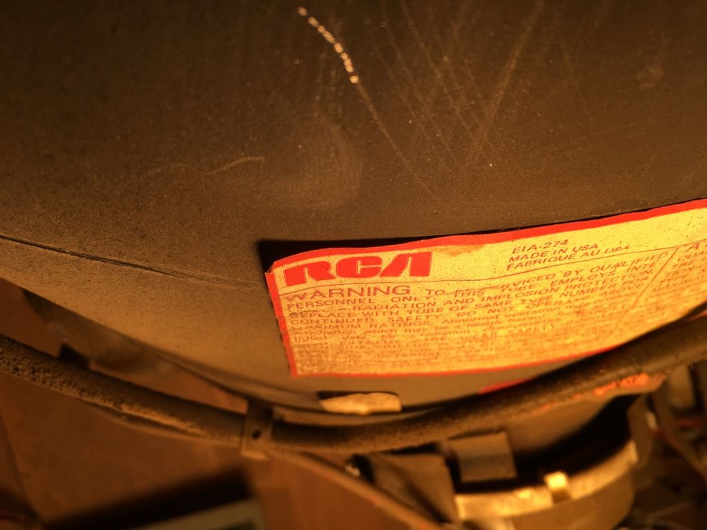

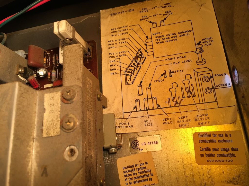

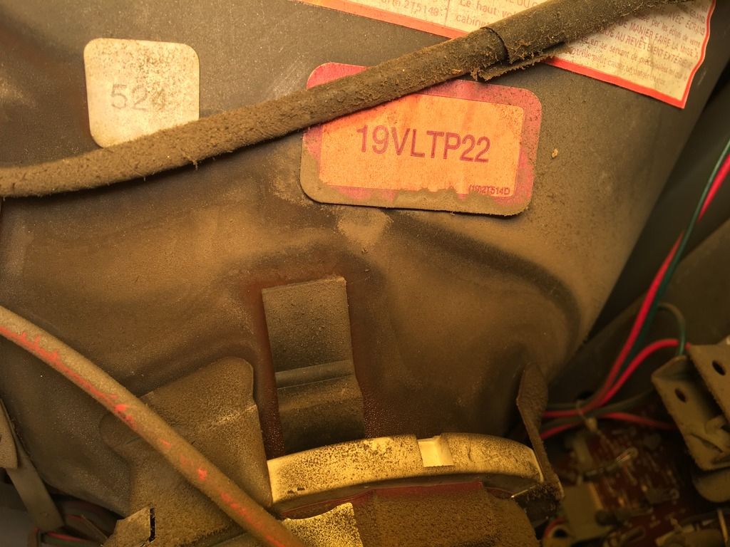

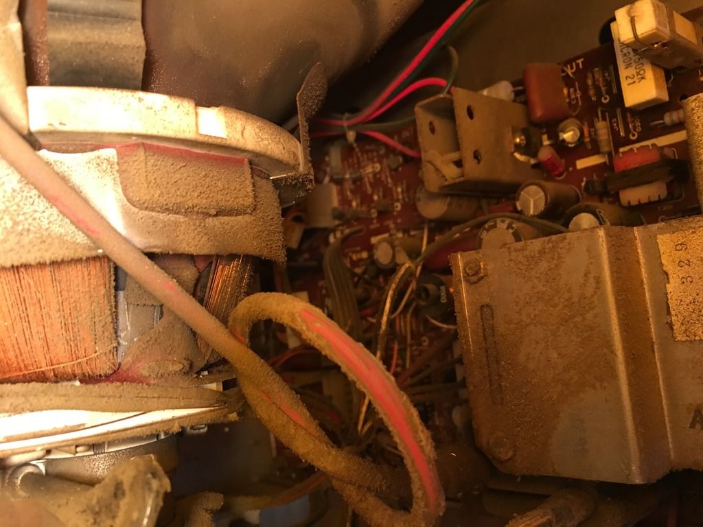

I was wondering if anyone knew what monitor this is and where I can get a capkit for it.

You can get fuse holders from Twisted Quarter, Arcadeshop, Mikes Arcade, etc...any standard electronics outlet, really....nothing special about them....just fuse holders that screw into the wood, then you attach wires on each side.....pretty blah....
But a good idea!

So this weekend, I got a little bit of time to work on this. I replaced all six of the fuses, and that still didn't fix the issue. I was still getting a garbled mess on the screen. Granted it looked more like game play than it did before. So, I tried my standard fix for Ms Pacman boards, I took it out and cleaned all the dust and junk off of it, and pressed every chip to make sure that they had a good connection.
I plugged it back in, and bam! It works! I need to get a capkit for the monitor, as it has a line that scrolls left to right, but the game works! It even has the speed chip in it!
So now, I just need to put in a capkit on it, and then start dealing with the water damaged parts at the bottom.
I finally got around to ordering a capkit for this project. Hopefully, I can get this one up and running soon. I have a couple of machines in the priority list ahead of it though.
