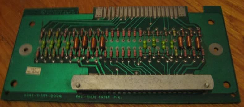

Random resets can be caused by the board interconnector not being tight. Check to make sure that the connector is seated firmly.
Also, if there's a filterboard in use, REMOVE IT.
Pic of a filterboard:
i dont have that board, I checked the connections, all tight. now the thing wont even boot up, I barley touched anything.
