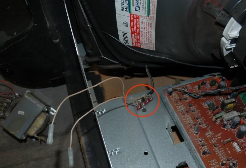

Hi all,
I'm putting a G07 into a Ms. Pacman and I've think I 've got everything figured out except for this. What is the component circled in the picture and where do the wires go? It looks like a ceramic resistor with diodes attached? There's 2 black wires that have been cut and two white wires with connectors on them.
Thanks!
those are your degauss wires.
are you sure that yoke and tube is compatible with a G07. or are you changing tube and all.
that frame looks like it was made for a G07 but that chassis on there is not.
Peace
Buffett
OK, thanks! That makes sense now.
That's a Hantarex MTC 9000 that's in there in the pic. I'm swapping it all back to a G07 tube, yoke and chassis.
