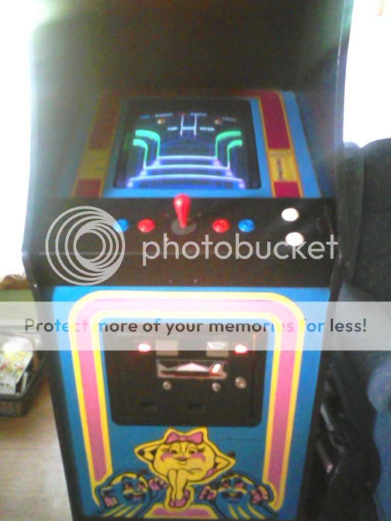

I hope nobody shoot's me for showing this picture here.
This is the Ms. Pac / 60-in-1 that I have given to my mother. It was a mothers day gift. I do have the original control panel/joystick/pbc and I didn't hack any of the original wiring at all to install this. I just simply used a jamma harness (should of done the converter deal) and power supply to run everything.
I would go with a 4 way joystick. The current 8 way one that is on here just SUCKS! So much so, that my mother and one of her friends had said the joystick was out of whack. I just haven't gotten around to ordering a 4 way yet.
I did get away with the 2 button setup, and 2 players also. I forget where I got the control panel offhand but they did have a 3 button / trackball option also.
Simple enough to take all that out and turn it back into Ms. Pac without much effort.
Original CRT is still in there even with some Ms. Pac burn. Not too noticable but can be seen playing certain games.
Before anyone starts knocking me down for the bat type joystick, at the time I had already put enough into the arcade and didn't have the extra cash to buy a ball top. The Ms. Pac didn't line up with that control panel so I had to use my spare joystick for it.

If that front art is original, that is pretty dang spiffy. No to very little fade and no lock bar holes. Bonus.
When I bought this the guy had told me it was hand painted by someone who took their time with it. Along with the front art the side art is just as nice. I didn't see any needs to do any touch ups just yet. Since it's not being showcased out in the living room (damn shame too). The no lock bar part, is a miracle (or fixed before being painted) since this was a machine out on a route at one point in time. Sticker from route was I believe '07?
Back on topic thou.. Anyways Guru, I hope the picture at least gives you an idea of the final product, thou there are different control panels and other setups to use. This one was convenient for me.
