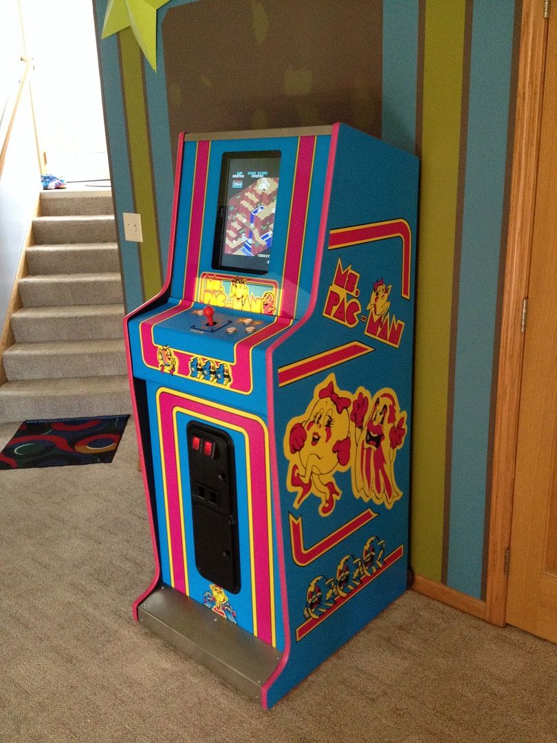

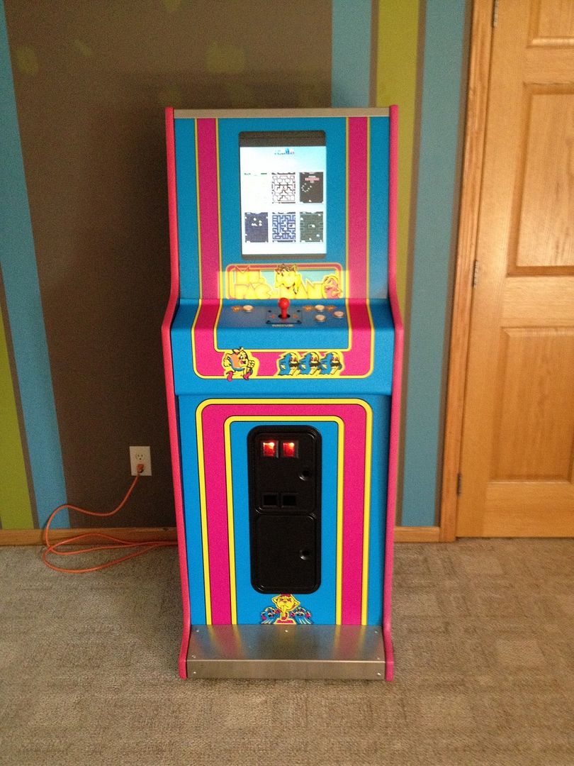

This project is coming together nicely. I was able to source a decent LCD monitor, a 60 in 1, and a nice switching power supply. I decided to add a lower marquee light box and LED light to illuminate what will be the above CP marquee:
I was also able to get most of the artwork installed:
Thanks go out to Rich at This Old Game, without whom this wouldn't have been possible. Just waiting on the glass bezel/ marquee combo and the CPO to finish her up. The auction is this Saturday.
The rest of the art arrived and I was finally able to finish the cosmetics and install the powdercoated but cobbled together coin door. I did run into a few snags along the way, however. With no die cut holes, the CPO took a long time to line up correctly. And, as I feared, the tempered glass bezel was too wide and didn't quite fit into the opening. I gave exact measurements and realized too late that I shoulda taken an 1/8" off for wiggle room. Live and learn. I ended up having to shave a little of the particle board off the inner edges of the monitor area and then carefully repainting them. My wife actually helped with that part, so it wasn't so bad. In the end it did work, as I was able to then slide the bezel into place when we were finished. It sounds scary but it actually turned out fine and still looks great, as you only really see about 3/16" of the inner sides due to the thickness of the bezel. Next up is wiring the speakers and control panel. Then I need to go in and set up the board correctly using the menu options. A few quick cell pics of the cab so far:
