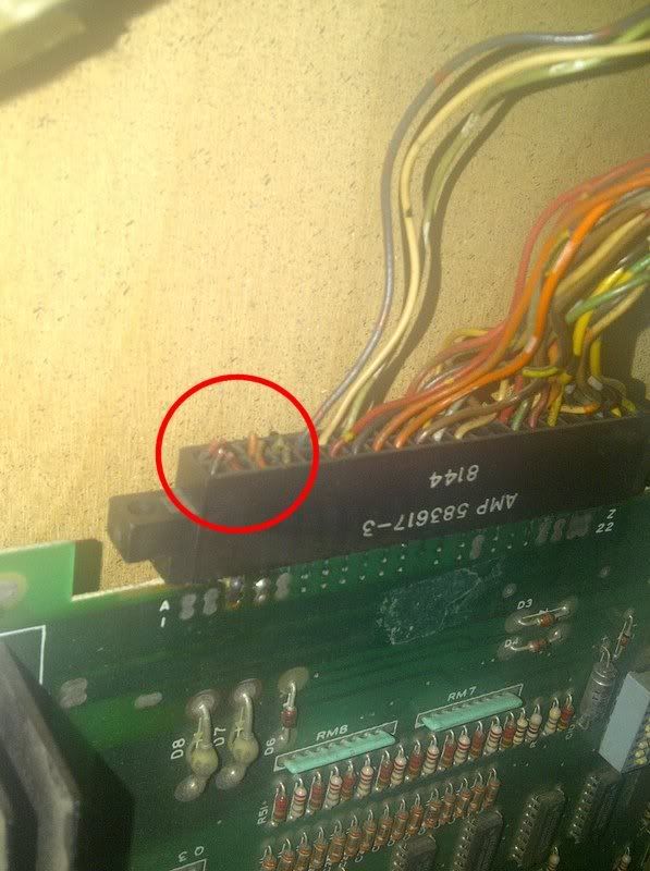

it's not playing blind. but i think i figured out the problem. After inspecting the pcb , i noticed the old board has wires soldered on to it..i looked at the edge connector and i seen some wires were clipped so it looks like someone thought it was slick to just bypass the connector and solder the wire to the board.
So at this point im confident its not the monitor but the one connection and the edge connector..it might be easier if i can find a ms.pac man wire harness.
...it might be easier if i can find a ms.pac man wire harness.
Naaa, grab a manual and check your the wiring on your harness vs what the manual says....
Or worst case, pm me and I'll send you some detailed pics of what the color scheme on your harness SHOULD look like....
This is a picture of the edge connector, noticeably there are broken wires, which is why they soldered them to the old board to bypass it.
I see those stubs, where are those SAME color wires on the harness? The ones that USED to be soldered to your old board? Here is what I'd do, make sure the pins are in that connector, then take the same color wires from the harness and solder them right to those stubs! Bingo, working game! Too bad you're not local, I'd have that thing working in 15 minutes!
I'll give it a go, not much room to work with but its worth a shot. Not much on those stubs i'll have to strip just a lil.
