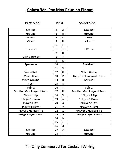

I just picked up a Ms pac/Galaga board.
Could you take a look, and tell me, how the P1 and P2 start buttons are wired?
Thanks

there are 2 sets of p1 p2 buttons, one for galaga one for pac on my machien. i think thats the main difference for this pcb to a regular jamma generic
That's what I was asking for. What wires hook to what?
Obviously something gets hooked to P1 start and P2 start. How do the other set of start buttons wire into the jamma connector?

looks like the galaga/pacmans are just standard jamma? so your 48/60 in 1 should plug and play and just experiment with games with one button now and see how you like it and if you like it then mod your control panel for another button
