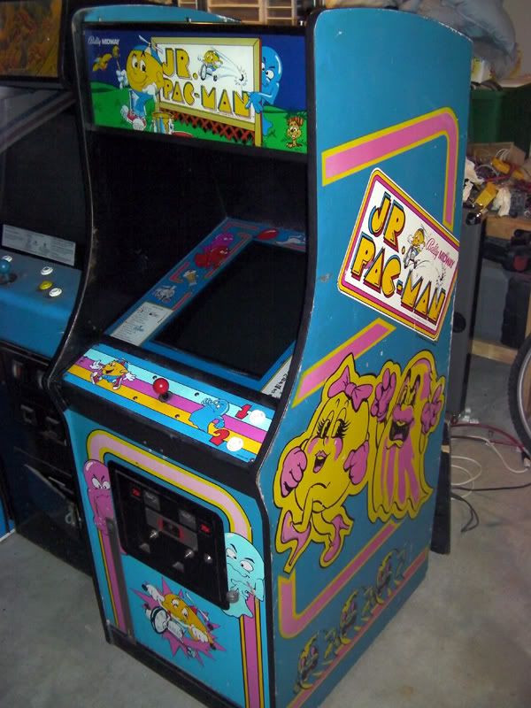

So I am cleaning up a cab a little for a sale. It was a Ms. Pac that an OP installed a Jr. Pac kit on to... it looked good except for the really cheezy ass Jr. Pac "side art"...
...so i figured I'd remove the Jr. Pac sticker to see what's under it. At worst, I could paint the cab black since it's running a 48-in-1 (w/converter...the original harness is intact).
Not bad! The white stuff you see is a little bit of the melted sticker residue. The only thing is that it left a sticker residue. Can someone give me advise at to what specific product I could use to remove the sticker residue but leave the original side art paint? The stuff I have would slather both off...
"Goo Gone" is safe from my experience. "Goof Off" is the strong stuff.
a few light application of goo-gone, then lightly clean area with a magic eraser and you should be set. I just removed sticker residue off a machine with this method and it came out great. Don't go nuts with the magic eraser though
yep, stick with "Goo Gone," the citrus-based adhesive remover.
i tried to do the same on a Pac cab (remove some JR stickers that were added by an op,) and i could not get them off without removing paint. glad you had much better results than i did!
A combination of heat gun and this $9.99 "heated decal remover" I got from Harbor Freight did the trick with very little difficulty. When that decal remover gets hot and encounters the warmed sticker from the heat gun, it comes off like butter.

Bought some Goo Gone. The stuff ABSOLUTELY SUCKS. I've been working for over an hour and a half trying to get all the residue off... I'm about 1/2 there.
There HAS to be a better way.
I can not recommend Goo Gone for this job to anyone. I feel ripped frankly.

Well... I needed the residue off TODAY as the buyer is coming tomorrow. While it was still work, believe it or not, WD-40 worked about two to three times as well as Goo Gone... and it didn't pull up the paint (well, extreme rubbing left some blue on the rag but so did the Goo Gone). It still SUCKED bigtime... that was a 3 hour freakin' job just to get a 2' x 10" or so sized piece of sticker residue off... ridiculous. There's gotta be SOMETHING better. I almost tried carb cleaner as that works pretty well at getting CPO residue off but man the stink... so I tried WD... and it worked better than the Goo Gone so I stuck with it until the residue was gone. I then washed it down with a wet rag and I am calling it a day.
