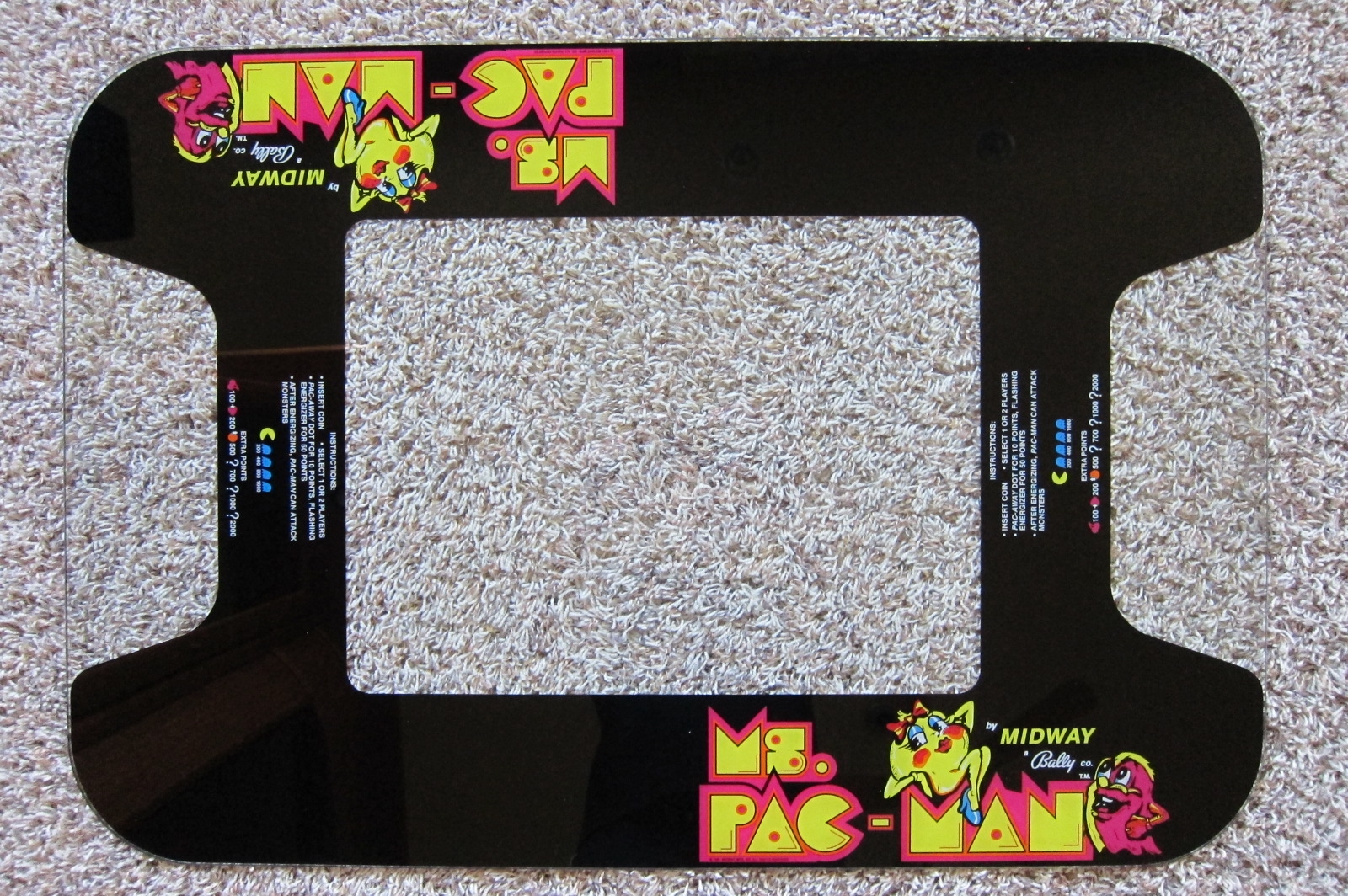

1. The wrinkling is normal in underlays. The only way to fix it is to replace it. PM VicShaf on here, he sells great Namco licensed repros.
Don't be afraid to remove it from the glass, it's not paper so it won't tear. Even if someone glued it down.

phoenixarcade.com has screen printed glass. The underlays were not original, the art was screen printed on the glass. the underlays may have been a cheap replacement for broken glass.
http://www.phoenixarcade.com/art.htm#MsPAC

That's good to know! I'm sure if the underlay WAS original, it would have been cheap paper or cardboard - and I would have torn it.
I have removed the glass now, and the plastic is actually quite nice (thick enough to not rip, but is missing a few small chunks here and there on the edge) It looks like beer / soda / who knows what ever else. It should clean up nicely - what are the odds on me removing graphics if I go after it with a Mr. Clean (OK, cheap Wal-Mart subsistute..) Magic Eraser?
A Magic Eraser shouldn't harm it as long as you don't clean the printed side. THe printed side you can use Goo Gone. It's called Lexan, very good stuff.
