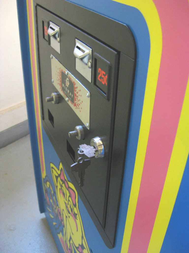

i color matched mine to the back door inside overspray
its close to what it looked when i go it but it's dark to most i see. It depends on what light it's in thou i guess...
before
after
I rolled mine, it sucked ass... but it looks great... I don't ever want to stencil again thou lol
If you notice i covered my registration marks with a slip of paper and then tape over it.....
why would i do that??? so the tape wouldn't pull the registration marks off like it did the first pass bahahaha..

The company that made the stencils is Escape Pod.
I was mistaken on the price, they were $200 for the entire set.
The quality seemed good, but removing the stencils paper backing was difficult because it keeps trying to pull the mask up as you peel.
The over spray and register marks were painted over with a brush.
The one thing I would change next time I do this is just using a can of black spray paint for the final stencil.
The black from the sprayer seemed to bleed under a little, I think because the lines for the black are kinda thin.
