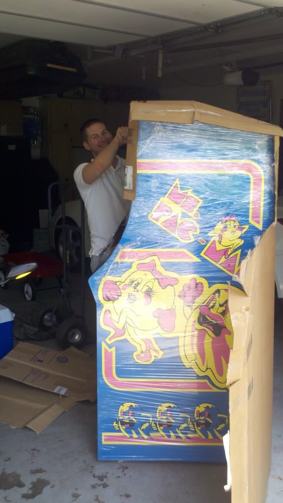

These are the three stages of stenciling on a Mrs.PacMan I am working on. Usually people put a giant glossy sticker on the machines sides, this old way looks way better in my opinion.

Very nice looking!What was the cost if you don't mind saying? I've been wondering how much more cost effective the stencil method would be.
The stencils were about $130 for the entire set.
I am not finished yet but have around ten hours invested so far.
Probably another five hours to finish, hopefully.
Placing and peeling the one use sticker stencil takes 90% of the time.
A reusable stencil would be way faster but I heard they cost $3000.
Stencils are the only way to go.
I noticed from the pics that you forgot to mask off the top part and had yellow over spray and then you forgot to cover up the registration points. But the last pic looks like you fixed those area. Just curious how you did that- with a roller or brush or did you mask off the stencils and respray the blue?

I'm doing the same thing with a pac-man cabinet, looks good, although the blue looks a little light, back in the day the cabinets were a bit of a darker blue.

I'm going to disagree a bit here, as I believe the correct color is a bit lighter.
Later run cabs used vinyl artwork that hard a darker blue, but the original sprayed cabs were a bit lighter.
Here's a shot of my DPTwiz built cab, that was sprayed by Brett's friend John Popson. I think it's a spot-on match to the original blue.

That cabinet is darker than the the faded one I posted and the OP's stencil job. What are you disagreeing with? The lighting of the photo of the girl playing is darker, but I think that your cabinet looks accurate.

Rich from This Old Game can chime in on this, but here's the little bit of UV color change that I understand:
  • Reds fade away
  • Blues fade darker
That's why the pinks on your cabinet are nearly invisible, and the blues are darker than before.

I wouldn't want the decaled cabinet as it's the particle board one. PB is the best substrate for laminate, decals, but I'd take a plywood cabinet over it any day. The style of the stenciled yellow and pink + screen printed black layer can't be beat.
