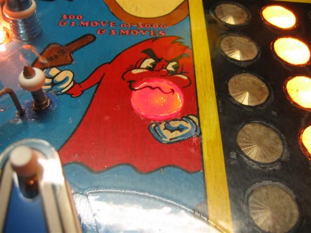

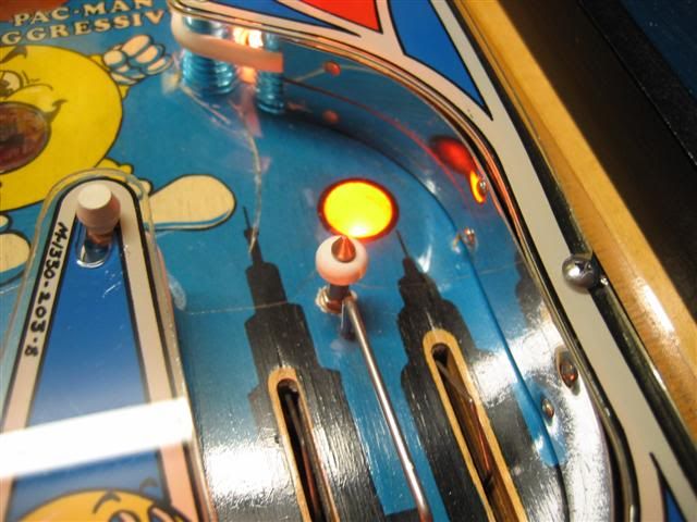

Looking for the clear plastic just to the left of the left flipper. Mine is broken next to the flipper & the ball hangs up on it.
Anyone have a parts machine that they can rob one off of?
Below is a pic with the upper plastic installed.
I suppose I could get creative with epoxy & rig something, but would rather not.
Also - There are two lamps that always stay on & I am not sure that they are supposed to- one is the light in the red ghost & the other is the amber light on the far right bottom lane (see pics). Can anyone tell me if they are meant to be on all of the time?
I have a Mr. & Mrs. Pacman which I restored about three years ago. I also had that same piece broken. What I did was bought a piece of clear 1/8" "Lexan" from "Home Depot" and used a scroll saw to cut out the new piece attached the small metal spacers and I was back in business. Both of those lights also remain on on mine when powered up and during play. Hope this helps!
Gary
I've done what gars943 recommends in the past, but if you cannot find a plastic or can't cut one, try putting a flat washer there and then the other plastic back in place. Or a clear Lexan flat washer to hide it even more.
Great ideas, thanks for the input!
