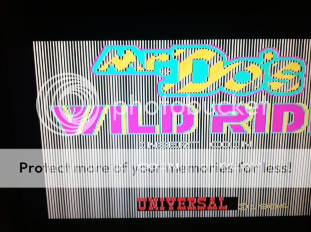

Mr. Do vertical lines

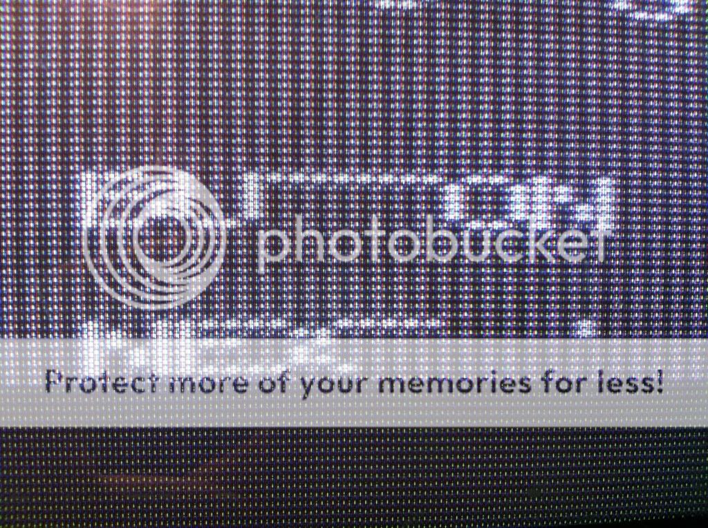

Here is a better picture to show the problem the letter t gets cut off in the diagnostic screen.
By the way, the diva gnostic said cpu1 & 2 OK and all roms OK
I tried using a rgb->VGA converter and hooking up a different monitor but the lines are still there and are more prominent.

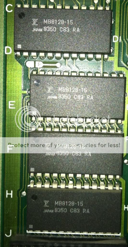

I have the same problem with a different game and I think it is a ram problem. When I cleaned the area near the ram on my board it went away for a short while and then came back.
I would try to reflow the solder to the connections before I start replacing the parts. Looks like the one at C/D on pin 4 could use a bit more solder. Piggy back a new part on them chips won't help if they do not make a connection. At least check the connections from top of chip to the trace.

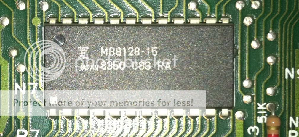

Here is what the manual says;
Five of these:
MB8128-150 NMOS 16k bit static RAM access 150 nsec

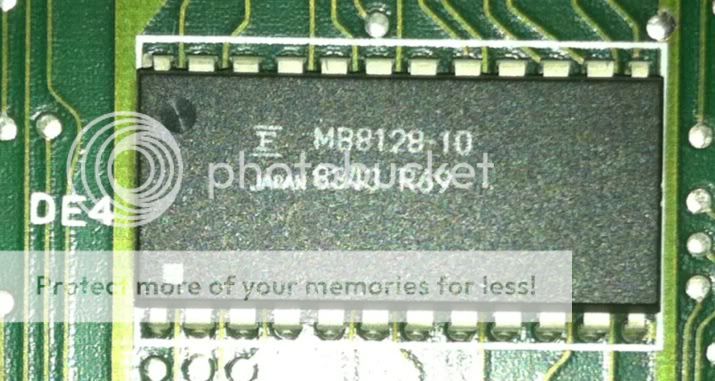

One of these:
Mb8128-100 NMOS 16k bit static RAM access 100 nsec

Well I fixed mine.
I put in the kitchen sink, while the kitchen dictator was out, and ran hot water all over the component side. Then put dish soap on it and scrubbed lightly with a soft brush so it would not move any of the frail components. I did this for about 2 mins and while rinsing with hot water. Dried it with hair dryer set on high fan and med to high heat. Dried it really well and finally put some extra heat on the interconnect pins. Plugged it in and voila, I no longer have the vertical streaks. This was obviously a connection problem and was an easy fix. Out of 3 boards I tried this on, 1 worked. So I am not real sure it is a ram problem as much as a connection problem.
I reflowed all the ram connections for connectivity and they all tested ok. I powered up the board and still have the same problem. I removed and reseated all the ROM chips I Also cleaned the entire board and still no luck. I think the diagnostic mode tests 3 of the 5 ram chips (according to the manual) with 12 test tones at 3 different pitches all 12 tones for each pitch beeped.
That makes me think it must be one of the 3 ram chips that are not specified as part if the RAM test. One has a lower access time 100ns instead of 150 so I would assume that chip is the video ram. Should I try replacing that one first? Any other tips?
