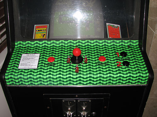

I've been doing my own restore and it seems that the Universal cabinet CP for Mr. Do had a left-hand joystick with one button on the right side. It also said "control" above the joystick hole. There's also a kit CP that has a central joystick with one left-hand button and one right-hand button (like Dig Dug).
Here's the original arcade flyer of Mr. Do. You can see there's a left-hand joy with right-hand button: http://www.arcadeflyers.com/?page=flyer&db=videodb&id=2592&image=1
The dedicated Mr. Do -- the one in the white Universal cabinet -- had the left handed setup with the joystick on the left and button on the right. Mr. Do was pretty widely sold as a conversion kit, so I've seen a lot more conversions than dedicated (especially since I've never come across a dedicated Mr. Do myself).
Here's a shot of my Mr. Do -- I've got buttons on both sides of the joystick. This is the typical conversion CPO, and you can see that there's a "THROW" label for both right/left handed button setups. There's also one in the wild just like this at Flashbacks in the Carousel Arcade in Seaside Heights, NJ.
I've also seen the generic green brick CPO, so I guess you can do whatever you want with the buttons here. In this case, the buttons both did the same thing, which obviously doesn't have any real purpose. (This is the "before" shot of mine.)
For the record: I was never a huge fan of the look of the dedicated cabinet. I'm also a right handed player and wanted to recreate the Mr. Do that I used to play in the sub shop down the street from my house... so I prefer the conversion.
